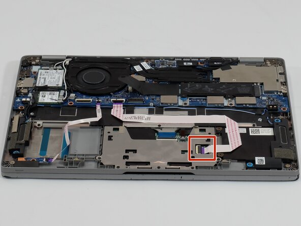

  9. Dell Latitude 5320 2-in-1 Touchpad Replacement: step 9, image 1 of 2 Dell Latitude 5320 2-in-1 Touchpad Replacement: step 9, image 2 of 2
    • Use your fingernail to flip up the ZIF latch on the connector securing the red/brown ribbon cable.
    • Slide the red/brown ribbon cable straight out of the socket.

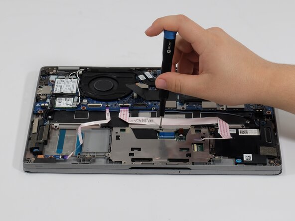

  10. Dell Latitude 5320 2-in-1 Touchpad Replacement: step 10, image 1 of 3 Dell Latitude 5320 2-in-1 Touchpad Replacement: step 10, image 2 of 3 Dell Latitude 5320 2-in-1 Touchpad Replacement: step 10, image 3 of 3
    • Using your fingertips, peel back the black flap to reveal all the screws.
    • Remove all seven 2mm screws using a Phillips #000 screwdriver.

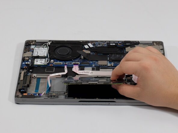

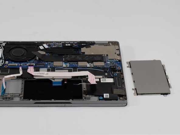

  11. Dell Latitude 5320 2-in-1 Touchpad Replacement: step 11, image 1 of 2 Dell Latitude 5320 2-in-1 Touchpad Replacement: step 11, image 2 of 2
    • Using your fingertips, remove the touchpad.
