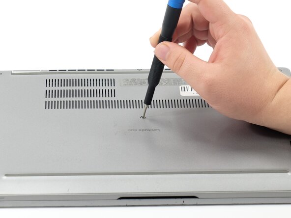

  2. Dell Latitude 5320 2-in-1 Fan Replacement: step 2, image 1 of 2 Dell Latitude 5320 2-in-1 Fan Replacement: step 2, image 2 of 2
    • Using a Phillips #000 screwdriver, loosen the eight captive screws that secure the bottom cover.
    • The screws will remain attached to the cover, so do not try to remove them completely. Turn each screw until it spins freely and you feel it no longer tightens.

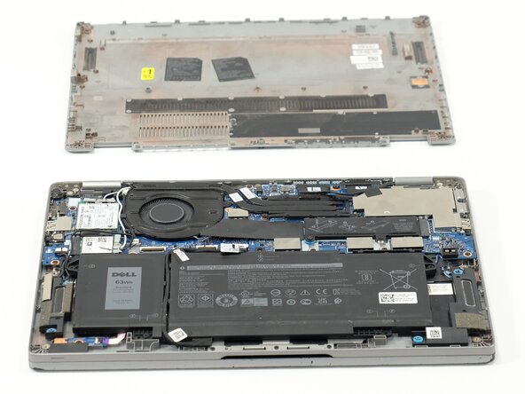

  3. Dell Latitude 5320 2-in-1 Fan Replacement: step 3, image 1 of 3 Dell Latitude 5320 2-in-1 Fan Replacement: step 3, image 2 of 3 Dell Latitude 5320 2-in-1 Fan Replacement: step 3, image 3 of 3
    • Insert an opening tool into the seam between the bottom cover and the rest of the device.
    • Gently work your way around the edges until the clips release. Lift the cover away and set it aside.

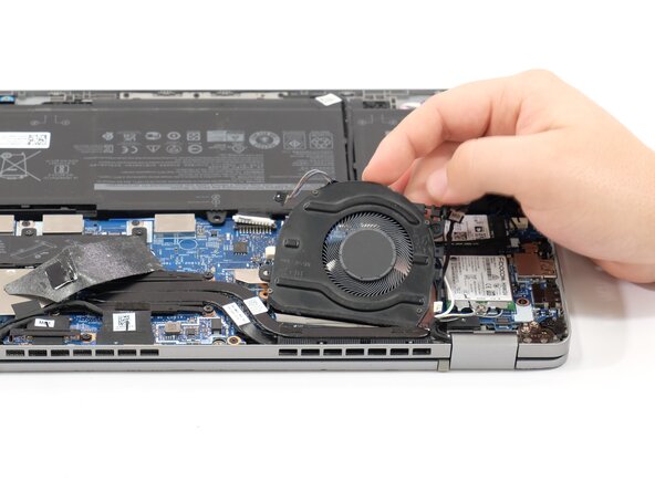

  6. Dell Latitude 5320 2-in-1 Fan Replacement: step 6, image 1 of 3 Dell Latitude 5320 2-in-1 Fan Replacement: step 6, image 2 of 3 Dell Latitude 5320 2-in-1 Fan Replacement: step 6, image 3 of 3
    • Remove the two 3mm fan screws using a Phillips #000 screwdriver.
    • Before lifting the fan, note that two cables are woven through the plastic tabs on the fan housing.
    • After carefully removing the wires from the plastic tabs carefully lift the fan unit out.
