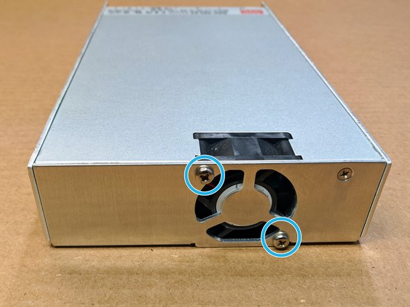

  3. CR-10S Pro Noctua Fan Upgrade, Removing the PSU Fan: step 3, image 1 of 3 CR-10S Pro Noctua Fan Upgrade, Removing the PSU Fan: step 3, image 2 of 3 CR-10S Pro Noctua Fan Upgrade, Removing the PSU Fan: step 3, image 3 of 3
    • Remove the 6 PSU screws securing the cover (circled in blue)
    • Next, remove the 2 screws securing the original 4020 Fan (circled in red)
  4. CR-10S Pro Noctua Fan Upgrade, Installing PSU Fan: step 4, image 1 of 3 CR-10S Pro Noctua Fan Upgrade, Installing PSU Fan: step 4, image 2 of 3 CR-10S Pro Noctua Fan Upgrade, Installing PSU Fan: step 4, image 3 of 3
    • Unplug the original fan cable
    • Original fan cable is glued down. Gently, pull up on the cable to remove after you unplug the connector
    • Route the new fan cable under the white wires
    • Plug in new fan cable
    • Mount fan with Self tapping screws included in the kit
    • Pay attention to the fan orientation and wire placement
    • Follow step 2 in reverse for reinstallation of the PSU cover
