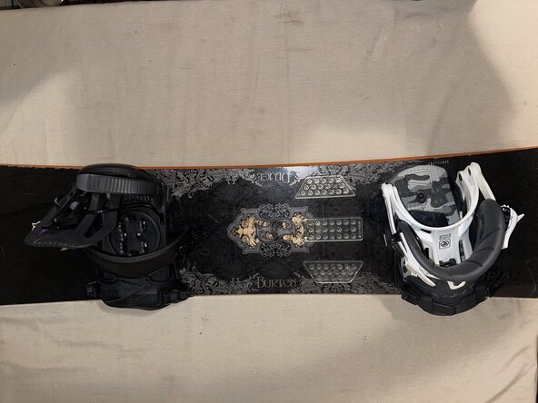

    • Use a screwdriver to remove all screws from the old snowboard setup by turning them counterclockwise.
    • Repeat this process for the second binding.
    • You will have eight total screws.

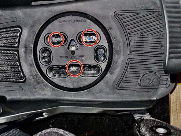

    • Align the multi-disk plate so only the three screw holes are visible, then secure it in place.
    • If four holes are visible, the plate is misaligned and can cause loose bindings.
    • Repeat this step for the second binding.

  6. Burton 3D Snowboard Binding Replacement: step 6, image 1 of 1
    • Loosely screw in all three screws into the binding once all multi-disk adjustments have been completed.
    • Caution: Try not to use a power drill because the inside of the board is easy to damage as well as the tips. Your hands should do an excellent job!
    • Repeat this on the second binding once done with the first one.
