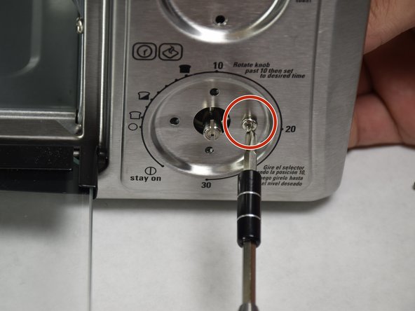

  11. Black and Decker TO1303SB Door Replacement, Door: step 11, image 1 of 2 Black and Decker TO1303SB Door Replacement, Door: step 11, image 2 of 2
    • Remove the two #2 Phillips Head x 5.5mm screws holding the timer controls to the face.
