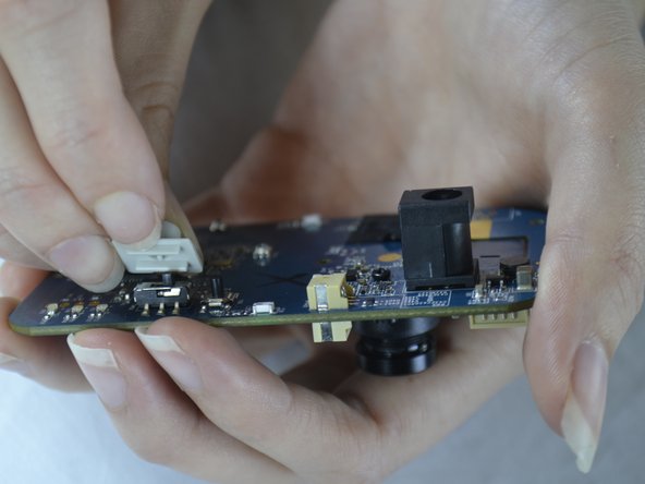

  11. Belkin NetCam HD Circuit Board Replacement: step 11, image 1 of 2 Belkin NetCam HD Circuit Board Replacement: step 11, image 2 of 2
    • Flip the circuit board back to the other side.
    • Unscrew the screw with a Phillips #0 screw driver.
  12. Belkin NetCam HD Circuit Board Replacement: step 12, image 1 of 1
    • Slide the attached piece from the lens holder device.
  13. Belkin NetCam HD Circuit Board Replacement: step 13, image 1 of 2 Belkin NetCam HD Circuit Board Replacement: step 13, image 2 of 2
    Tool used on this step:
    Buy
    • Use the tweezers to pull the white attachment out from the port a little.
    • Then, take your fingers and gently pull the white attachment out from the tan port.
  14. Belkin NetCam HD Circuit Board Replacement, Switch Cover: step 14, image 1 of 2 Belkin NetCam HD Circuit Board Replacement, Switch Cover: step 14, image 2 of 2
    • On the back of the board pull the switch slowly upward to take it off.
