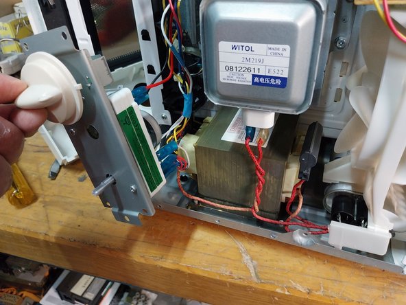

    • Microwave oven with knob or inner knob that activates the timer is 'loose, turns 360º, multiple turns'.
    • The oven is disassembled by removing all the screws from the casing, the screw on the right side, was expressly placed by the manufacturer to make repair difficult, is a Torx T10 Security screw, (With a central security pin) The screwdriver for this type screw is now easier to find than it was years ago.

    • Once the casing is removed, we can access the interior, in the timer portion, we must remove the 2 Philips + screws that hold the front casing.
    • The 2 front knobs have an 'edge' so if the timer assembly isn't disassembled, they can't be removed.

    • Once the 2 screws have been removed, the casing design allows us to raise it slightly and pull it towards the front.
    • Once the casing is out, we can easily remove the 3 screws that hold the metal frame that supports the timer.

    • We see the timer chassis disassembled from the housing and the knob lip that prevents its removal as indicated in step 2.

    • View of the timer chassis.

    • View of the timer Dial or knob 'cracked' so it slips when inserted into the stem.
    • On this occasion, since they didn't have time to look for better solutions, having a metric 8 nut on hand, I tried the option of threading a nut on the plastic stem. Since there is plenty of space for the nut in the back.
    • I turn the nut with the help of a wrench, about 3 turns, it does not matter if it is fully threaded as it could break the plastic.

    • Views of what the nut looks like placed on the plastic stem, performing its clamping job perfectly.
    • On this occasion a repair was carried out in 15 minutes.
