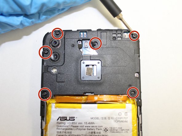

    • Using a Phillips #00 screwdriver, remove the six screws across the top mid frame and gently lift the top assembly piece. It should detach easily and can be set aside.

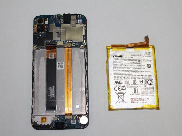

    • Use a halberd spudger to pry up the battery's press fit connector from the motherboard.
    • Gently pry the battery out of the case, taking care not to bend or puncture the battery.
    • It may help to apply a bit of heat through the screen to loosen the battery adhesive.
