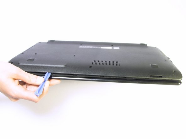

Use the plastic opening tool to separate the keyboard plate cover from the bottom cover. In order to do this, insert the plastic opening tool in between the keyboard plate cover and the bottom cover, then slide along edges to pry open.
  • Use the plastic opening tool to separate the keyboard plate cover from the bottom cover. In order to do this, insert the plastic opening tool in between the keyboard plate cover and the bottom cover, then slide along edges to pry open.

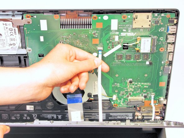

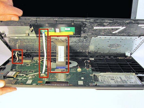

Locate the three ribbons connecting the keyboard plate cover to the bottom cover.
  • Locate the three ribbons connecting the keyboard plate cover to the bottom cover.
Invert the laptop in order to gain access to the ribbons. Remove each ribbon by flipping the small white plastic flap up and gently pulling on the ribbon. Remove each ribbon by flipping the small white plastic flap up and gently pulling on the ribbon.
  • Invert the laptop in order to gain access to the ribbons.
  • Remove each ribbon by flipping the small white plastic flap up and gently pulling on the ribbon.
Don't remove the ribbons, just move the keyboard slightly forward to remove the old battery and insert the new one (just make sure they are all connected when you put it back)
Flyer292 - Reply

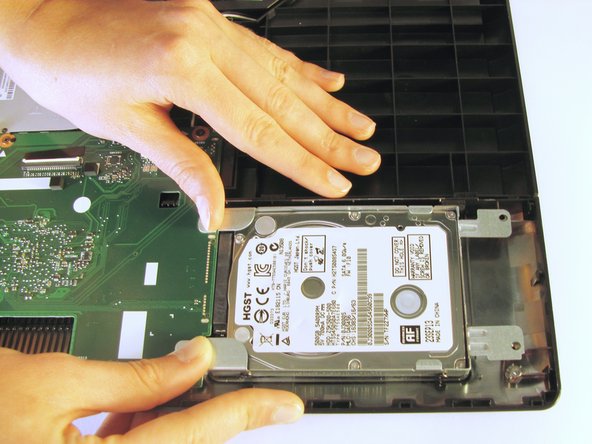

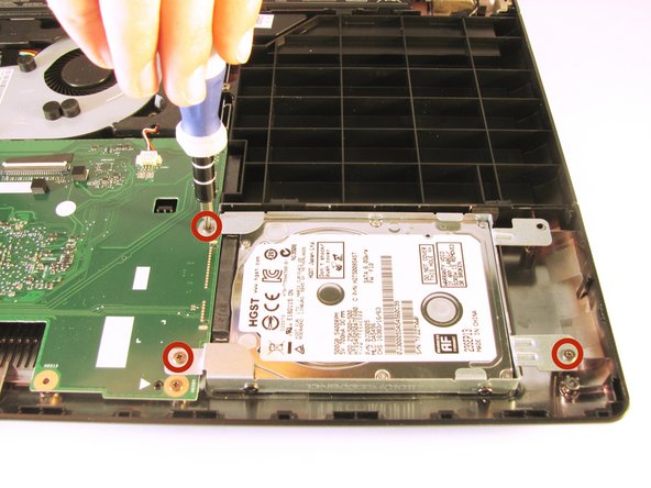

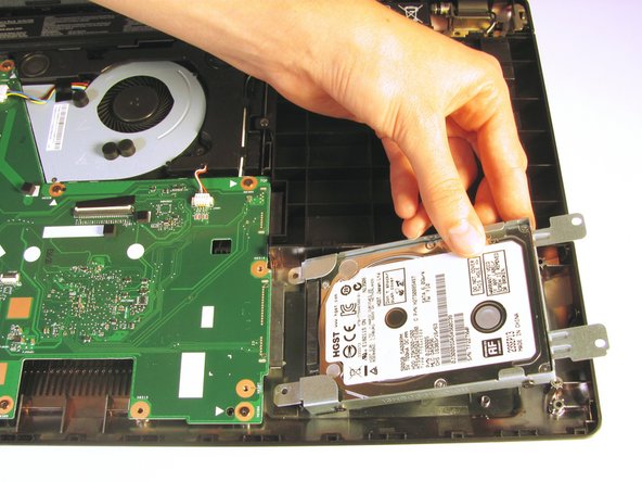

Unscrew the three 5.5 mm Phillips #0 screws with the Phillips #0 Screwdriver.
  • Unscrew the three 5.5 mm Phillips #0 screws with the Phillips #0 Screwdriver.
Once the screws have been removed, place your fingers on the left corners and push the hard drive towards the right edge of the laptop (relative to the picture).
  • Once the screws have been removed, place your fingers on the left corners and push the hard drive towards the right edge of the laptop (relative to the picture).
Once it is free, remove the hard drive from its internal cavity.
  • Once it is free, remove the hard drive from its internal cavity.

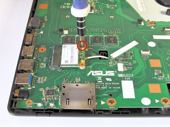

Use the Phillips #0 Screwdriver to unscrew the 3.2 mm Phillips #0 screw which attaches the WiFi card to the motherboard.
  • Use the Phillips #0 Screwdriver to unscrew the 3.2 mm Phillips #0 screw which attaches the WiFi card to the motherboard.
Disconnect the Wifi card from the motherboard by gently sliding it towards the right edge of the laptop.
  • Disconnect the Wifi card from the motherboard by gently sliding it towards the right edge of the laptop.

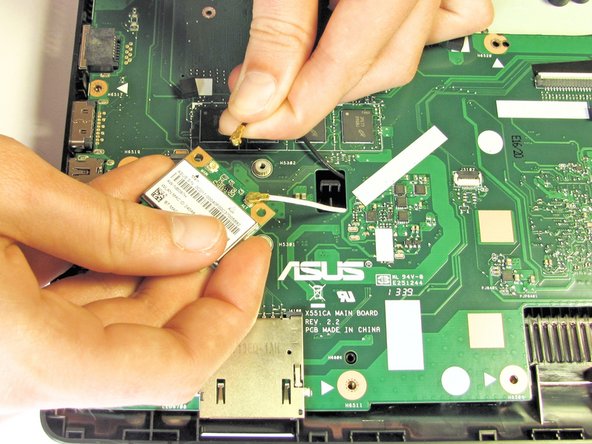

Remove each of the two small antenna connections by disconnecting one wire at a time. Each wire should easily unsnap from the Wifi card.
  • Remove each of the two small antenna connections by disconnecting one wire at a time. Each wire should easily unsnap from the Wifi card.
mine only had the black cable and the small wifi card was slightly different. the card itself has two available connections and is labeled as to where the black cable (main) and white cable if it were present (aux) cables connect.
Josh - Reply

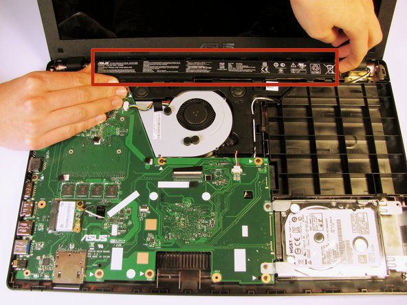

Remove the battery from the laptop by applying pressure on both ends and lifting it out of the case.
  • Remove the battery from the laptop by applying pressure on both ends and lifting it out of the case.

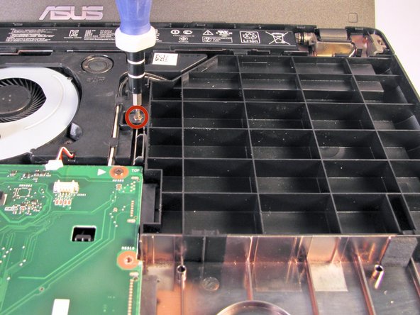

With the Phillips #0 Screwdriver, remove the nine 5.5 mm Phillips #0 screws which hold the motherboard in place.
  • With the Phillips #0 Screwdriver, remove the nine 5.5 mm Phillips #0 screws which hold the motherboard in place.
there is one more screw that must be removed at the bottom right corner of the motherboard, just out of view.
Josh - Reply

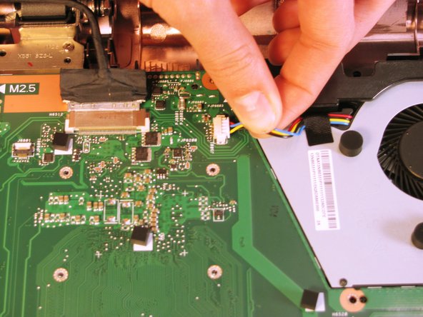

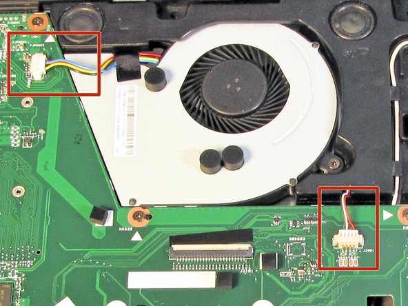

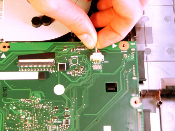

Now, locate the two wires connected to the motherboard. Now, locate the two wires connected to the motherboard.
  • Now, locate the two wires connected to the motherboard.
Remove the wires by easily pulling them parallel to the motherboard's surface. The wires are very fragile. Be sure to pull carefully so that they do not break!
  • Remove the wires by easily pulling them parallel to the motherboard's surface.
  • The wires are very fragile. Be sure to pull carefully so that they do not break!

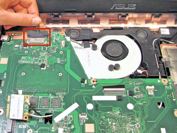

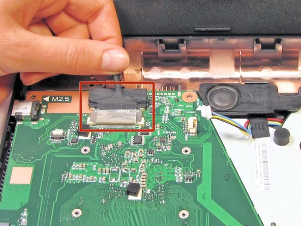

Remove the LCD display connection by gently pulling on the attached wire. Gently lift any tape that may be holding the connection.
  • Remove the LCD display connection by gently pulling on the attached wire.
    • Gently lift any tape that may be holding the connection.
If the tape is removed when disconnecting, be SUPER sure that the connector is the right way before reconnecting. I managed to brake this connector by putting it in the wrong way! Both sides look very similar.
Ben Garrod - Reply

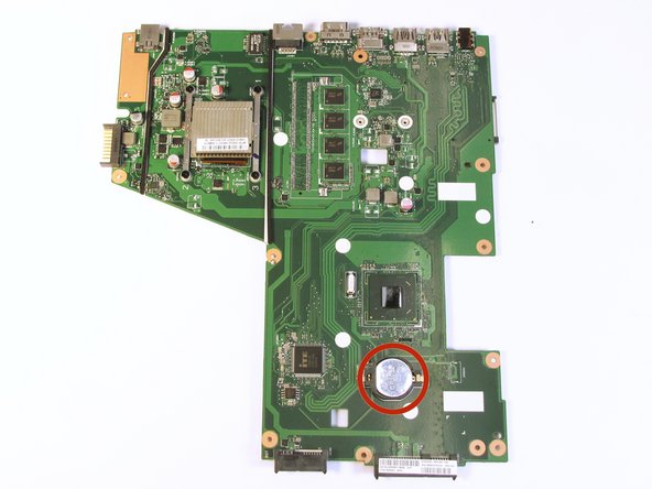

Flip over the motherboard and locate the CMOS battery.
  • Flip over the motherboard and locate the CMOS battery.
Use the plastic opening tool to pry the battery out of its plastic casing in the motherboard.
  • Use the plastic opening tool to pry the battery out of its plastic casing in the motherboard.
Lastly, lift and remove the CMOS battery from the motherboard.
  • Lastly, lift and remove the CMOS battery from the motherboard.

What is the correct battery to use? Where can I purchase it?
Mark Thompson - Reply
the battery is a cr2032. Its one of the most common battery sizes available just about anywhere from a grocery store to amazon.
Josh -
