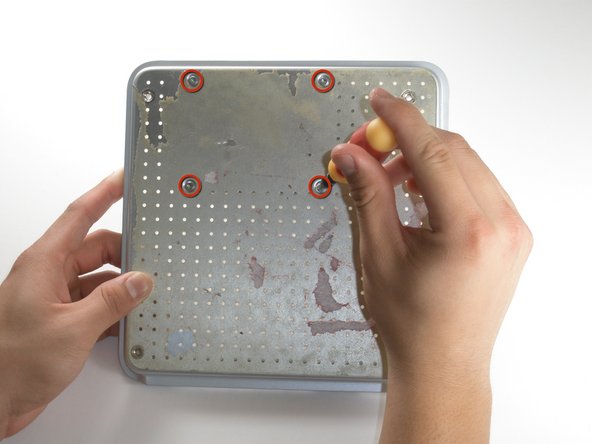

    • Remove the four T10 Torx screws that secure the lower case to the upper case.

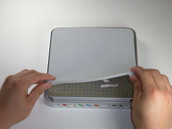

    • Carefully lift the lower case from the upper case enough to allow access to the internals of the Apple TV.
    • Be aware that the hard drive is physically attached to the lower case and that a ribbon cable runs from the drive to the logic board in the upper case.

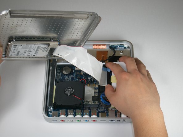

  4. Apple TV 1st Generation Hard Drive Replacement: step 4, image 1 of 2 Apple TV 1st Generation Hard Drive Replacement: step 4, image 2 of 2

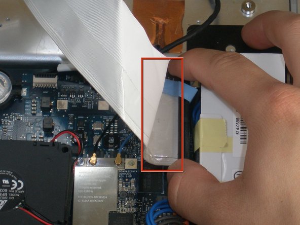

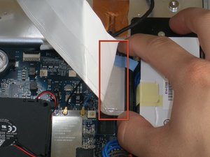

    • Carefully pull the hard drive data cable straight up from its socket on the logic board.
    • During reassembly, make sure the hard drive data cable is firmly seated in its socket on the logic board; otherwise, during boot-up you will see a flashing question mark "?".

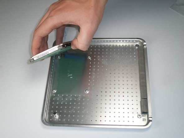

    • Remove the four T8 Torx screws securing the hard drive to the lower case.
  6. Apple TV 1st Generation Hard Drive Replacement: step 6, image 1 of 1
    • Peel and remove the hard drive up off the lower case.
    • The hard drive is held on to the lower case with mild adhesive.
    • Disconnect the hard drive data cable from its socket on the hard drive.
    • If you are replacing your hard drive, ensure to transfer the hard drive data cable to your new hard drive.
    • Hard drive remains.
  7. Apple TV 1st Generation Hard Drive Replacement, Hard Drive: step 7, image 1 of 1
    • Align the new hard drive with the screw holes on the lower case.
    • While holding the hard drive in place, insert and tighten the screws back into the lower case.
