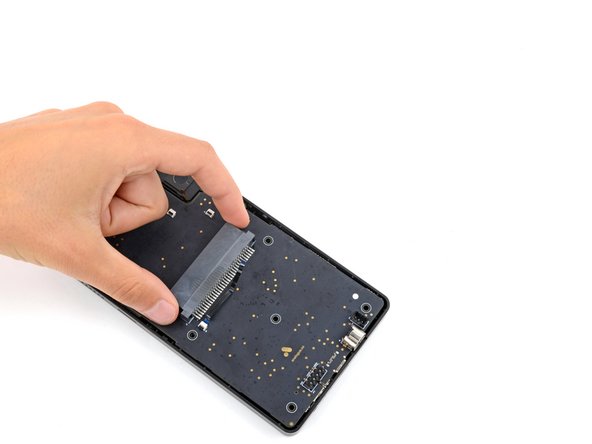

  7. Analogue Pocket Main Board Replacement, Reposition the button board: step 7, image 1 of 3 Analogue Pocket Main Board Replacement, Reposition the button board: step 7, image 2 of 3 Analogue Pocket Main Board Replacement, Reposition the button board: step 7, image 3 of 3
    • Swing the bottom edge of the button board up and over the cartridge reader.
    • Set the board on top of the cartridge reader so the cable's connector is facing the bottom of the device.
    • During reassembly:
    • Put the top edges of the board under their tabs on the rear shell.
    • Lay the board onto the rear shell so the alignment posts go into their circular cutouts on the board.
    • Press the board down until the plastic clip engages.

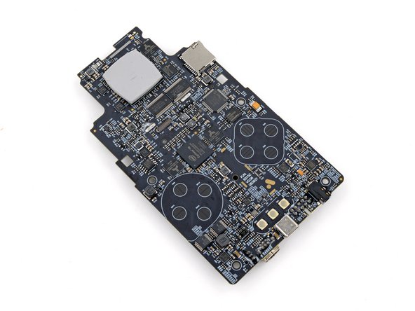

  17. Analogue Pocket Main Board Replacement, Remove the main board: step 17, image 1 of 3 Analogue Pocket Main Board Replacement, Remove the main board: step 17, image 2 of 3 Analogue Pocket Main Board Replacement, Remove the main board: step 17, image 3 of 3
    • Lift and remove the main board from the front shell.
    • To prevent damaging any surface mounted components, lay the board on your workspace cartridge reader side down.
  18. Analogue Pocket Main Board Replacement, Reassembly information: step 18, image 1 of 3 Analogue Pocket Main Board Replacement, Reassembly information: step 18, image 2 of 3 Analogue Pocket Main Board Replacement, Reassembly information: step 18, image 3 of 3
    • Before installing your new board, make sure it has a thermal pad. If the board doesn't come with a pad, follow this step to transfer the old one.
    • Use the flat end of a spudger to gently lift the thermal pad until you can grab it with your fingers.
    • If the pad breaks, don't worry. Just transfer each piece to the new board.
    • Use your fingers to transfer the pad to the new board.
    • Use the flat end of a spudger to press the edges of the thermal pad until it's centered.
