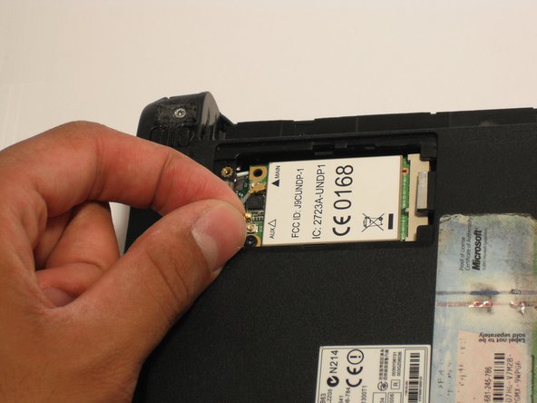

Disconnect the two antenna cables from the left side of the wireless card.
  • Disconnect the two antenna cables from the left side of the wireless card.

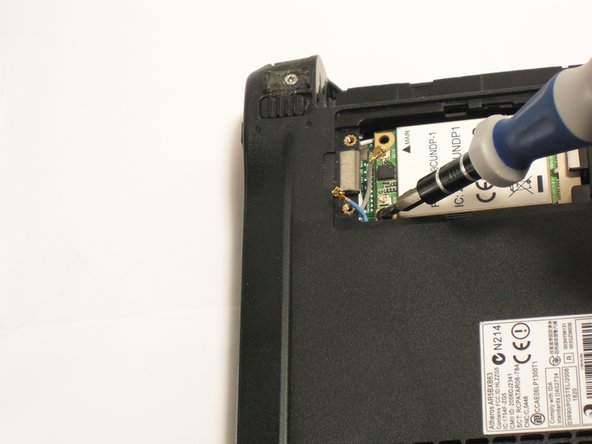

Remove the single 3.9 mm Phillips #1 screw from the bottom left of the wireless card.
  • Remove the single 3.9 mm Phillips #1 screw from the bottom left of the wireless card.
Gently lift up the left side of the wireless card and slide the card out of its socket.
  • Gently lift up the left side of the wireless card and slide the card out of its socket.

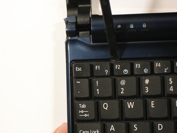

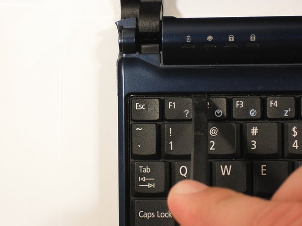

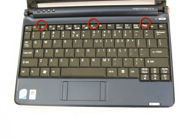

There are three tabs located on the top of the keyboard. Start with the spudger pointing towards the display and pry up to push each tab off the keyboard. As you move to the next tab, ensure the previous tab doesn't reset itself.
  • There are three tabs located on the top of the keyboard.
  • Start with the spudger pointing towards the display and pry up to push each tab off the keyboard.
  • As you move to the next tab, ensure the previous tab doesn't reset itself.

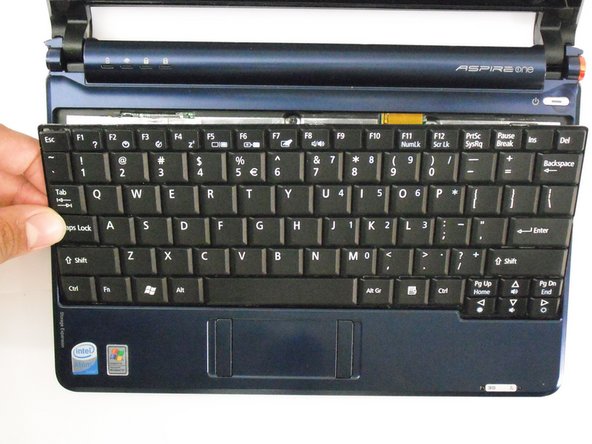

Lift top of keyboard up. If it doesn't lift easily, there may be tabs on the sides - use the tool to ease them aside and/or shift the keyboard from side to side. There is a short ribbon cable connecting the keyboard to the netbook.
  • Lift top of keyboard up. If it doesn't lift easily, there may be tabs on the sides - use the tool to ease them aside and/or shift the keyboard from side to side.
  • There is a short ribbon cable connecting the keyboard to the netbook.

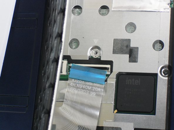

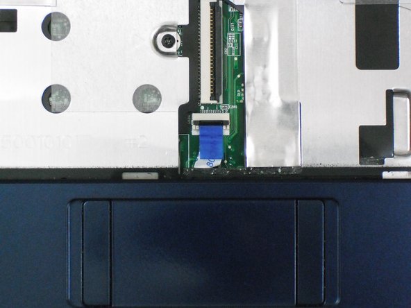

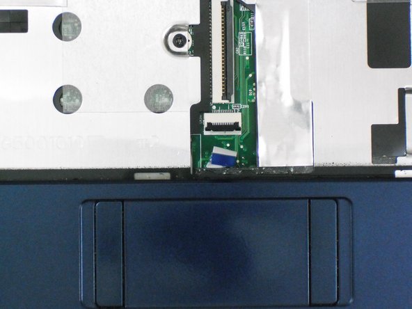

Flip up the retaining flap on the trackpad ribbon cable ZIF connector. Using the blue tab, pull the trackpad ribbon cable from its socket on the motherboard. Using the blue tab, pull the trackpad ribbon cable from its socket on the motherboard.
  • Flip up the retaining flap on the trackpad ribbon cable ZIF connector.
  • Using the blue tab, pull the trackpad ribbon cable from its socket on the motherboard.

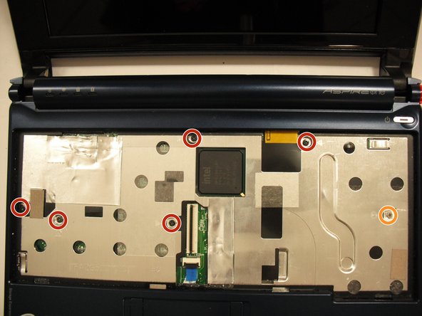

Remove the five black 4.7 mm Phillips #0 screws from the metal casing. Remove the single silver 4.3 mm Phillips #00 screw from the right side of  the metal casing.
  • Remove the five black 4.7 mm Phillips #0 screws from the metal casing.
  • Remove the single silver 4.3 mm Phillips #00 screw from the right side of the metal casing.

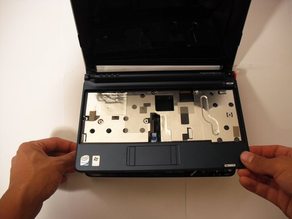

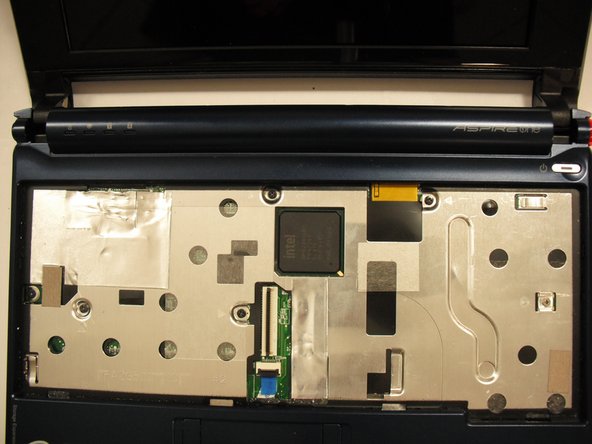

Starting at the red rings along the hinge, insert a spudger or plastic opening tool into the seam between the two halves of the case. Slide the spudger toward the front of the device, releasing the small clips that hold down the top case.
  • Starting at the red rings along the hinge, insert a spudger or plastic opening tool into the seam between the two halves of the case.
  • Slide the spudger toward the front of the device, releasing the small clips that hold down the top case.
  • Gently lift off the top case.

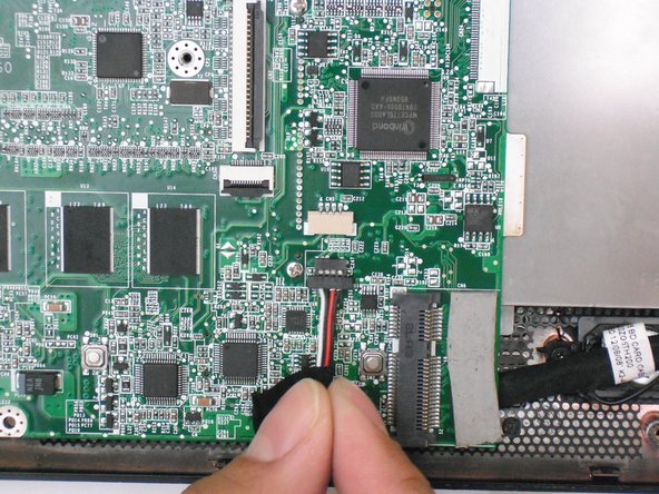

Disconnect the two antenna cables from the right side of the wireless card.
  • Disconnect the two antenna cables from the right side of the wireless card.

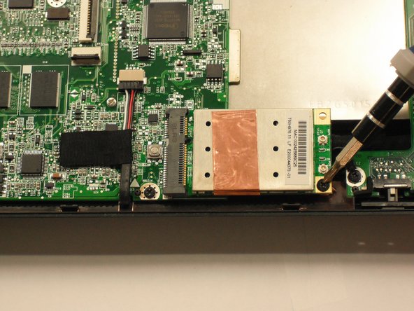

Remove the single 3.9 mm Phillips #1 screw from the wireless card.
  • Remove the single 3.9 mm Phillips #1 screw from the wireless card.

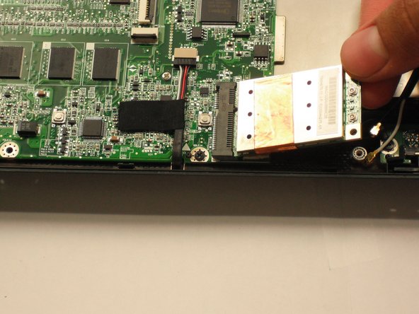

Gently pull the wireless card to the right and slide it out of its socket.
  • Gently pull the wireless card to the right and slide it out of its socket.

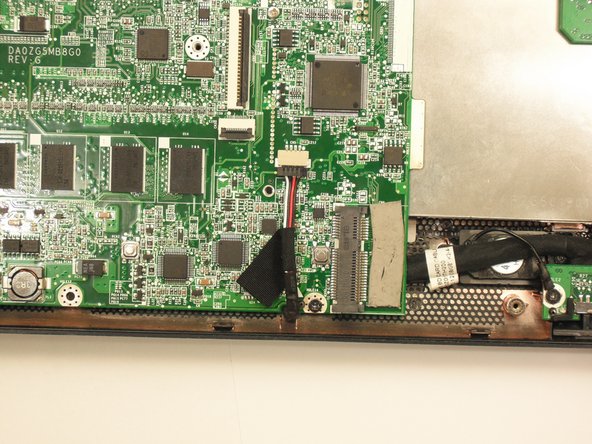

Disconnect the display cable from the top left of the motherboard.
  • Disconnect the display cable from the top left of the motherboard.
Disconnect the speaker cable from its socket on the motherboard. Disconnect the speaker cable from its socket on the motherboard.
  • Disconnect the speaker cable from its socket on the motherboard.

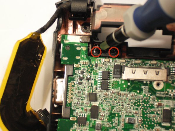

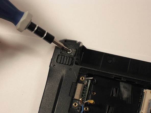

Remove the two 4.7 mm Phillips #1 screws that connect the display to the motherboard.
  • Remove the two 4.7 mm Phillips #1 screws that connect the display to the motherboard.

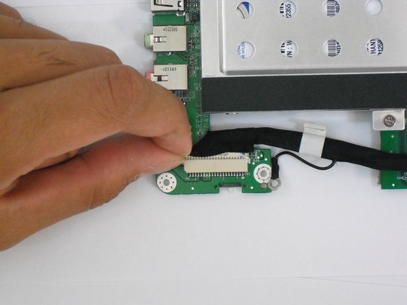

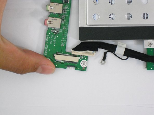

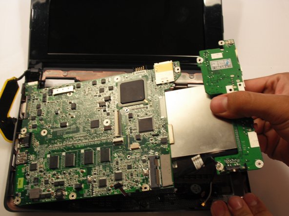

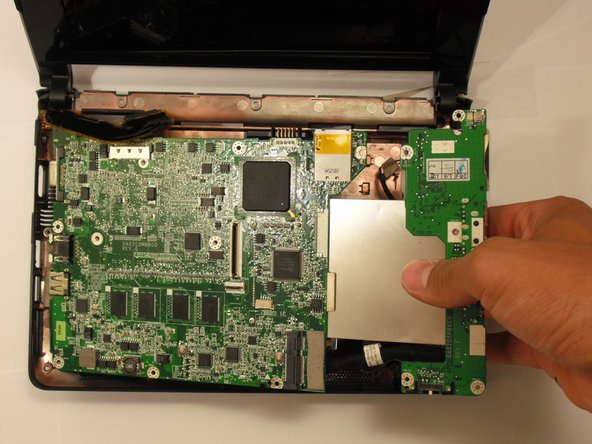

Gently lift the I/O board up from the right side of the case.
  • Gently lift the I/O board up from the right side of the case.
    • The I/O board is attached to the motherboard by a short cable.

Lift the entire motherboard assembly out the case.
  • Lift the entire motherboard assembly out the case.

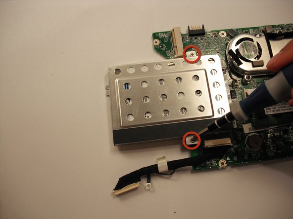

Turn the motherboard over so that the RAM is facing up.
  • Turn the motherboard over so that the RAM is facing up.
Disconnect the I/O board from the motherboard. Disconnect the I/O board from the motherboard.
  • Disconnect the I/O board from the motherboard.
This step (29) isn’t required to remove the hard disk drive.
montazmeahii - Reply
Remove the two 4.7 mm Phillips #0 screws that hold down the hard drive.
  • Remove the two 4.7 mm Phillips #0 screws that hold down the hard drive.

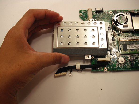

Pull the hard drive straight out from the motherboard.
  • Pull the hard drive straight out from the motherboard.

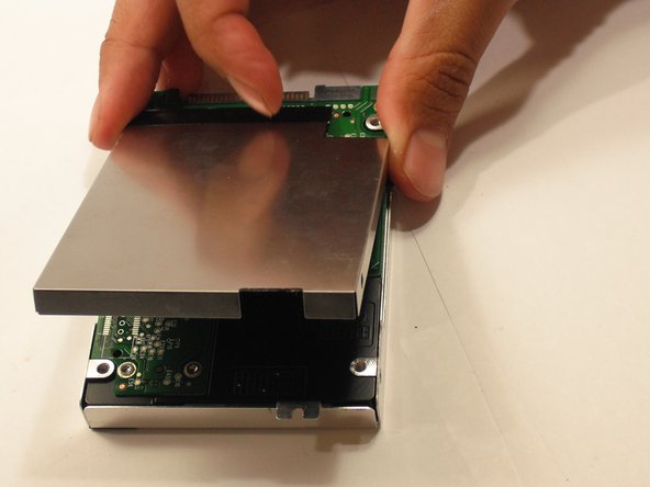

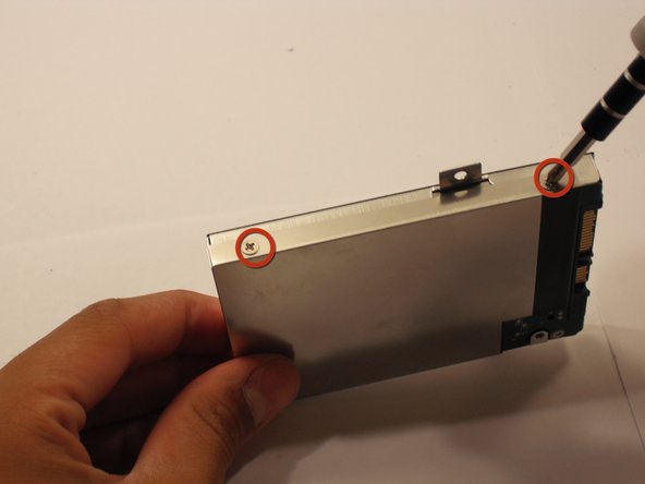

Remove the four 3.9 mm Phillips #1 screws from the hard drive casing.
  • Remove the four 3.9 mm Phillips #1 screws from the hard drive casing.
    • There are two screws on each side of the casing.
Remove the upper and lower casing from the hard drive.
  • Remove the upper and lower casing from the hard drive.

Not the easiest upgrade I've ever done (perhaps the most difficult, actually), but I got it done. Removing the keyboard was the trickiest step for me. Be patient. If you can work one of the corner releases, you can put a flat-blade screwdriver under the corner of the keyboard and work on the other releases (starting at the far corner, then the centre).
The other tricky problem I had was getting the little ribbon cable for the trackpad properly reconnected after completing the project. (I thought the keyboard cable would be the tricky part, but it turns out to be pretty easy.) Be patient and you'll be fine. You may want to test (with a mouse handy) before you reinsert the keyboard.
