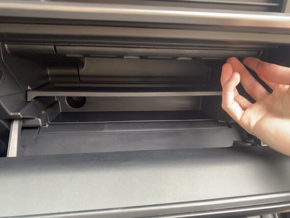

  2. 2024 Mazda CX-30 Cabin Air Filter Replacement: step 2, image 1 of 3 2024 Mazda CX-30 Cabin Air Filter Replacement: step 2, image 2 of 3 2024 Mazda CX-30 Cabin Air Filter Replacement: step 2, image 3 of 3
    • Make sure you have a full view of the glove compartment.
    • Squeeze each the four latches found at the top of the compartment and gently pull down.
    • The latches should be pulled in order from right to left.
