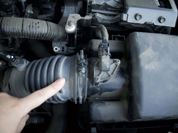

    • Find the large black plastic air filter housing on the driver's side of the engine bay.
    • Identify the air intake duct connected to the housing.
  3. 2022 Mazda CX-5 Engine Air Filter Replacement: step 3, image 1 of 3 2022 Mazda CX-5 Engine Air Filter Replacement: step 3, image 2 of 3 2022 Mazda CX-5 Engine Air Filter Replacement: step 3, image 3 of 3
    • Use a Phillips #2 screwdriver to loosen the hose clamp securing the intake hose to the air filter housing cover.
    • Remove the three 16.0 mm Phillips #2 screws securing the top cover of the housing.
    • Release the spring‑loaded tension tab if present.

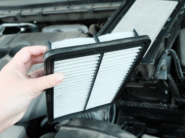

    • Remove the air intake duct from the housing cover.
    • Gently lift the housing cover. You may need to tilt it back slightly to free the rear tabs.
    • Remove the old air filter with both hands.
    • Inspect the inside of the airbox for dust, leaves, or debris and clean it out manually.

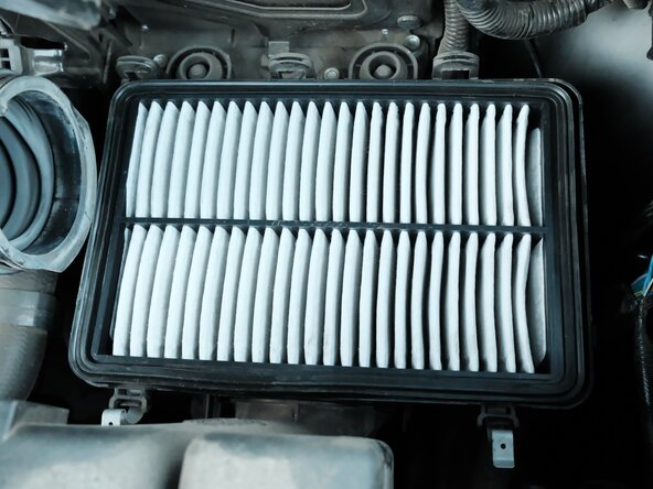

    • Place the new air filter into the housing in the same orientation as the old one.
    • Ensure the rubber seal seats evenly around the edges to prevent unfiltered air from entering the engine.
