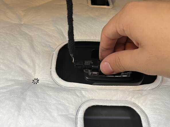

  4. 2019 Chevrolet Traverse Driver Side Trunk Taillight Replacement: step 4, image 1 of 3 2019 Chevrolet Traverse Driver Side Trunk Taillight Replacement: step 4, image 2 of 3 2019 Chevrolet Traverse Driver Side Trunk Taillight Replacement: step 4, image 3 of 3
    • Squeeze and pull the clip away to disconnect the electrical wire from the trunk liner.

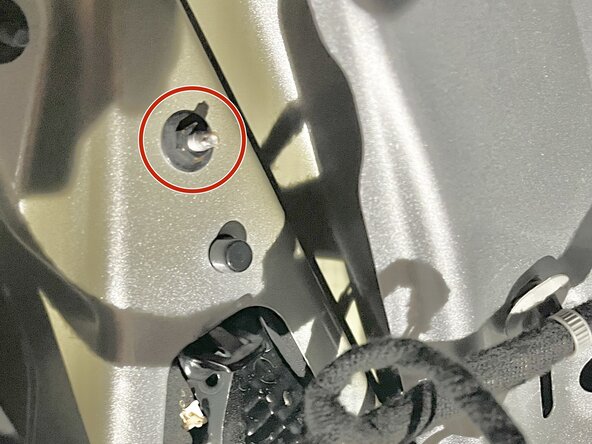

    • Remove the bolts that are holding the taillight in place with a socket wrench that has an 8 mm (5/16) socket attachment.
  7. 2019 Chevrolet Traverse Driver Side Trunk Taillight Replacement: step 7, image 1 of 3 2019 Chevrolet Traverse Driver Side Trunk Taillight Replacement: step 7, image 2 of 3 2019 Chevrolet Traverse Driver Side Trunk Taillight Replacement: step 7, image 3 of 3

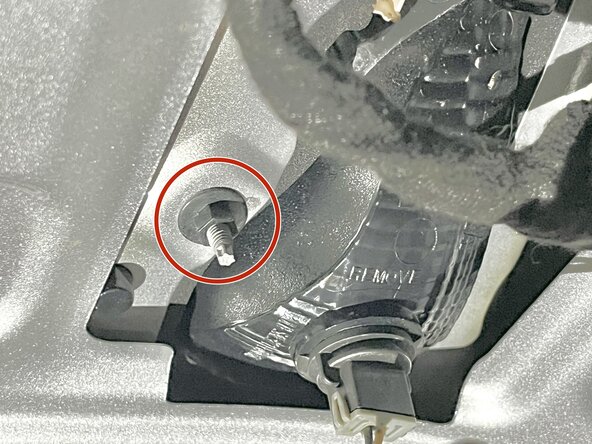

    • Remove the second bolt holding down the taillight with a socket wrench that has an 8mm (5/16) socket attachment.
  8. 2019 Chevrolet Traverse Driver Side Trunk Taillight Replacement: step 8, image 1 of 3 2019 Chevrolet Traverse Driver Side Trunk Taillight Replacement: step 8, image 2 of 3 2019 Chevrolet Traverse Driver Side Trunk Taillight Replacement: step 8, image 3 of 3

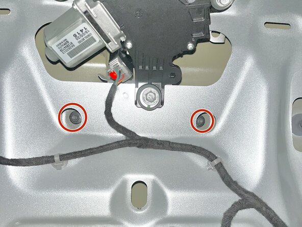

    • Remove the two bolts located in the middle of the trunk. This allows the taillight to be removed by using a socket wrench with an 8 mm (5/16) socket attachment.
