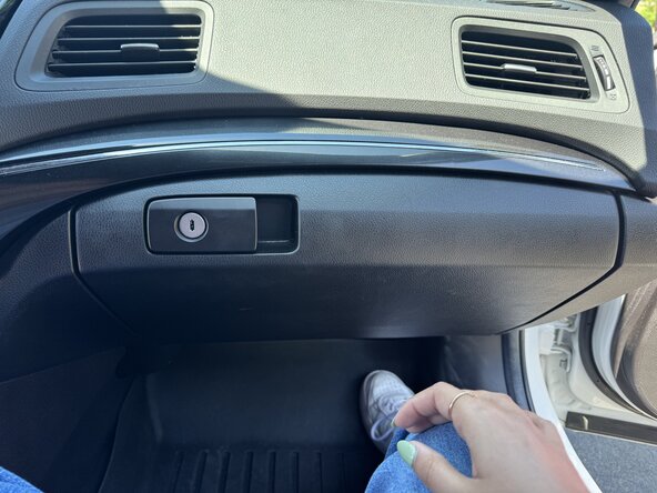

    • Open the glove box, located in front of the passenger seat on the right side of the vehicle.
    • Empty the glovebox.
