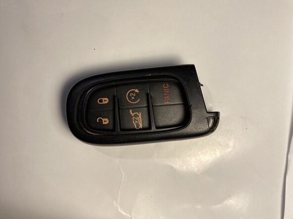

    • Press the small release button on the side of the key fob.
    • Press and hold that side button firmly — you should feel or hear the mechanism disengage.
    • While keeping the button pressed, pull the mechanical key straight out (do not twist).

    • Reinsert the mechanical key into its designated slot.

    • Press each button on the fob to ensure they all work correctly.
