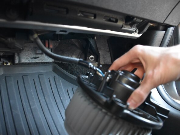

  6. 2009-2012 Honda Fit  Blower Motor and Blower Motor Control Module Replacement Replacement: step 6, image 1 of 3 2009-2012 Honda Fit  Blower Motor and Blower Motor Control Module Replacement Replacement: step 6, image 2 of 3 2009-2012 Honda Fit  Blower Motor and Blower Motor Control Module Replacement Replacement: step 6, image 3 of 3
    • Use a T20 Torx screwdriver to release the screws securing the blower motor.
    Ask FixBot
  7. 2009-2012 Honda Fit  Blower Motor and Blower Motor Control Module Replacement Replacement: step 7, image 1 of 3 2009-2012 Honda Fit  Blower Motor and Blower Motor Control Module Replacement Replacement: step 7, image 2 of 3 2009-2012 Honda Fit  Blower Motor and Blower Motor Control Module Replacement Replacement: step 7, image 3 of 3
    • Slide the motor out of the slot.
    • The motor is heavy, so take care handling it.

  8. 2009-2012 Honda Fit  Blower Motor and Blower Motor Control Module Replacement Replacement: step 8, image 1 of 3 2009-2012 Honda Fit  Blower Motor and Blower Motor Control Module Replacement Replacement: step 8, image 2 of 3 2009-2012 Honda Fit  Blower Motor and Blower Motor Control Module Replacement Replacement: step 8, image 3 of 3
    • Squeeze the clip to release the wire.
    Ask FixBot
