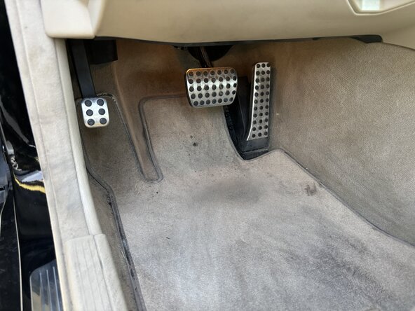

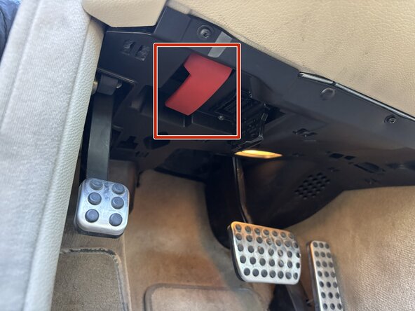

    • Open the driver's side door and locate the red hood-release handle on the lower dash panel, just left of the brake pedal.
    • Pull the handle towards you until the hood pops.
    • At the front of the vehicle, release the secondary latch above the grille area, and lift the hood.
