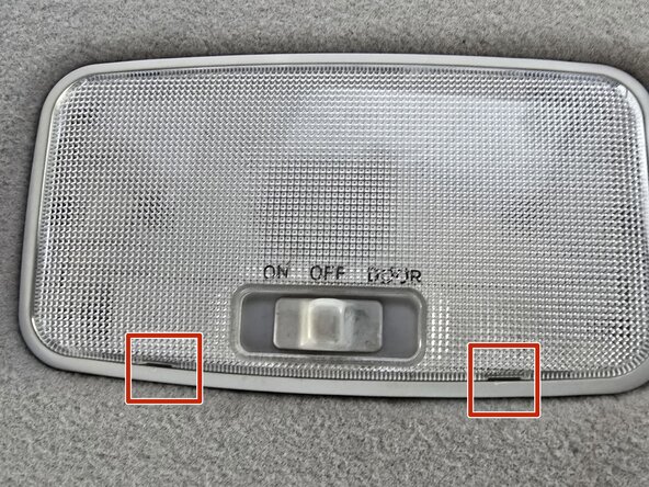

  2. 2006-2013 Toyota Corolla Cabin Lights Replacement: step 2, image 1 of 3 2006-2013 Toyota Corolla Cabin Lights Replacement: step 2, image 2 of 3 2006-2013 Toyota Corolla Cabin Lights Replacement: step 2, image 3 of 3
    • Insert the end of a spudger into the narrow openings at the bottom of the light cover and pry up to release the light cover.
    • After completing this step, the lid will be loose and could fall on your face if you are not careful and catch the lid on time.

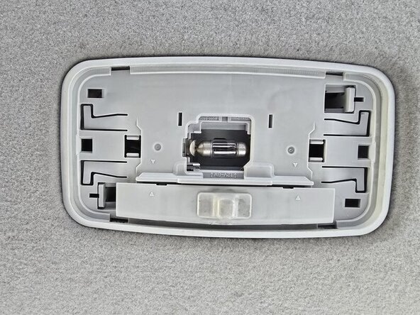

  3. 2006-2013 Toyota Corolla Cabin Lights Replacement: step 3, image 1 of 2 2006-2013 Toyota Corolla Cabin Lights Replacement: step 3, image 2 of 2
    • Remove the light cover.
  4. 2006-2013 Toyota Corolla Cabin Lights Replacement: step 4, image 1 of 3 2006-2013 Toyota Corolla Cabin Lights Replacement: step 4, image 2 of 3 2006-2013 Toyota Corolla Cabin Lights Replacement: step 4, image 3 of 3
    • Pull back the mechanism holding the bulb in place and remove the old bulb.
  5. 2006-2013 Toyota Corolla Cabin Lights Replacement: step 5, image 1 of 2 2006-2013 Toyota Corolla Cabin Lights Replacement: step 5, image 2 of 2
    • Insert the new bulb into the end of the holder with the hole.
    • There is no specific bulb orientation for this step, either side can be inserted, and the light will still work.

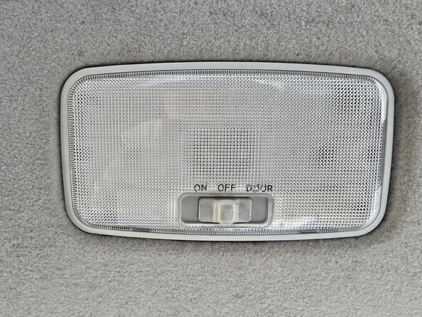

  9. 2006-2013 Toyota Corolla Cabin Lights Replacement: step 9, image 1 of 1
    • Slide the switch to turn the cabin light on. If it doesn't work, repeat steps 1-11 with a new bulb.
