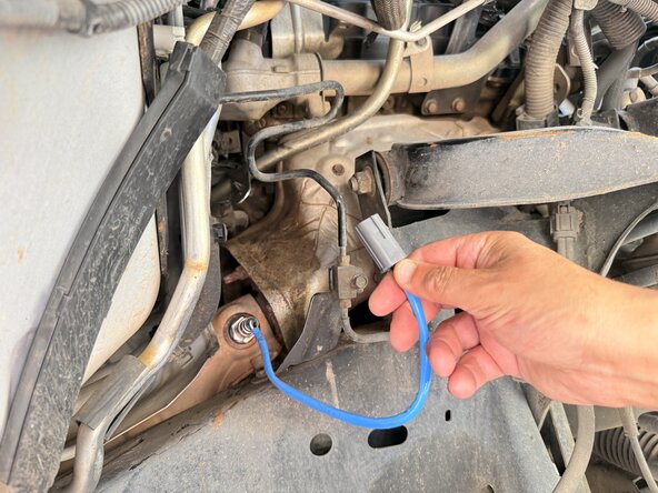

  3. 2005-2012 Nissan Pathfinder Upstream O2 Sensor (Bank 1, Sensor 1) Replacement: step 3, image 1 of 3 2005-2012 Nissan Pathfinder Upstream O2 Sensor (Bank 1, Sensor 1) Replacement: step 3, image 2 of 3 2005-2012 Nissan Pathfinder Upstream O2 Sensor (Bank 1, Sensor 1) Replacement: step 3, image 3 of 3
    • Trace the sensor wire.
    Ask FixBot

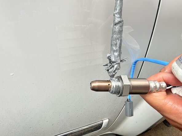

  6. 2005-2012 Nissan Pathfinder Upstream O2 Sensor (Bank 1, Sensor 1) Replacement: step 6, image 1 of 2 2005-2012 Nissan Pathfinder Upstream O2 Sensor (Bank 1, Sensor 1) Replacement: step 6, image 2 of 2
    • Apply a thin layer of high-temp anti-seize lubricant to the threads of the new sensor.
    • Do not allow any lubricant to touch the sensor tip (the perforated metal end). Some new sensors already come with anti seize on the threads which you can identify as it is of a different color than the O2 sensor threads.
