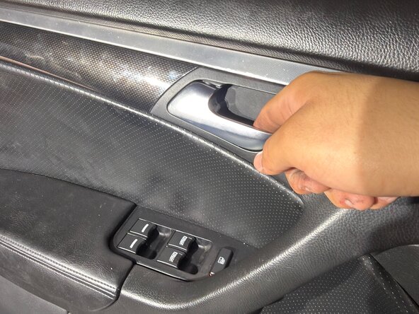

  1. 2004-2008 Acura Tl Door Handle Cable Replacement, Door Handle Cable: step 1, image 1 of 1
    • The tools needed to complete this project
    • Screw driver
    • Ratchet with 10 mm socket
    • Prying tool
    • Curved hook pick
    Ask FixBot

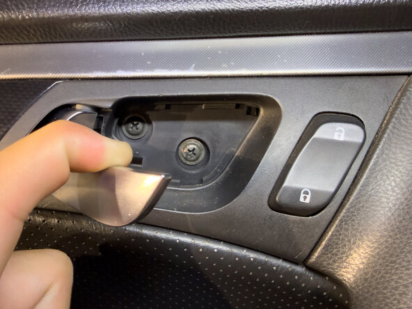

  2. 2004-2008 Acura Tl Door Handle Cable Replacement: step 2, image 1 of 3 2004-2008 Acura Tl Door Handle Cable Replacement: step 2, image 2 of 3 2004-2008 Acura Tl Door Handle Cable Replacement: step 2, image 3 of 3
    • For step #1, you will need to locate all your bolts to remove the door panel to have access to the cable.
    Ask FixBot
