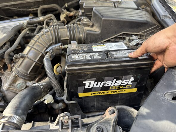

    2. 2003-2007 Honda Accord Highbeam Headlight Replacement: step 2, image 1 of 3 2003-2007 Honda Accord Highbeam Headlight Replacement: step 2, image 2 of 3 2003-2007 Honda Accord Highbeam Headlight Replacement: step 2, image 3 of 3
      • Loosen and remove both the positive and negative connectors before lifting and removing the battery.
      • Always remove the negative terminal first.
