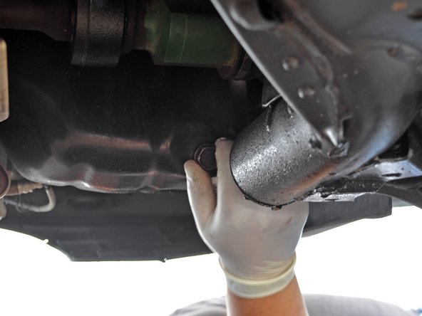

Locate the 19 mm hex oil drain plug. It is on the passenger side of the car, facing towards the rear of the car.

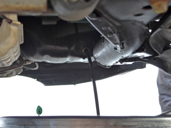

Place the oil drain pan below the oil drain plug.
Use a 19 mm box end wrench to turn the oil drain plug counter-clockwise until you can turn it by hand.
Finish removing the oil drain plug with your hand. Oil will begin streaming out of the oil pan when you finish removing the plug
Once the draining oil has slowed to a drip, wipe the old oil off the area around the drain hole with a clean rag or towel.
Place the oil drain plug back over its hole and turn it clockwise by hand as far as possible.
Finish tightening the oil drain plug with the 19 mm box end wrench until it is snug.

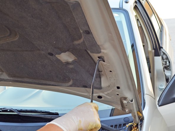

Pull up on the hood release latch and simultaneously lift the hood open.
Place the hood prop rod into the hole in the hood marked by an arrow.

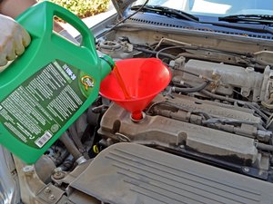

Locate the oil filler cap. It is on the front passenger side of the engine's valve cover.
Twist the cap counter-clockwise by hand and pull it off the valve cover.
Place the funnel into the oil filler hole.
Pour 4 quarts of 10W-30 oil into the engine. Use one hand to stabilize the funnel to help prevent spills.
Remove the funnel, place the oil filler cap over the oil filler hole and twist the cap clockwise until it is snug.
