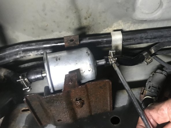

  8. 1998 Nissan Frontier Fuel Filter Replacement: step 8, image 1 of 2 1998 Nissan Frontier Fuel Filter Replacement: step 8, image 2 of 2
    • Using a flat head screw driver, work loose the fuel line if it has been on the fitting for many years. Using your hands or a pair of pliers gently rotate and pull on the line to remove the fuel line completely from the fitting.

  10. 1998 Nissan Frontier Fuel Filter Replacement: step 10, image 1 of 1
    • Put the fuel line on the filter that is closest to the front of the vehicle first.
    • This will allow you to have more space while installing the other hose onto the other end of the fuel filter. Installing the hoses onto the fittings can be a bit tedious so you may have to apply some pressure to fully have the fuel line back on.
