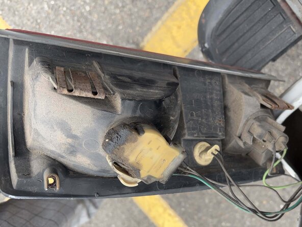

  2. 1987 Chevrolet S10 Taillight Blinker Light Bulb Replacement: step 2, image 1 of 2 1987 Chevrolet S10 Taillight Blinker Light Bulb Replacement: step 2, image 2 of 2
    • Gently pull the taillight outward to expose the yellow light housing.
    • Do not pull the taillight away completely, as cables are still connected to the light assembly.

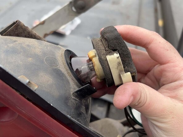

  3. 1987 Chevrolet S10 Taillight Blinker Light Bulb Replacement: step 3, image 1 of 2 1987 Chevrolet S10 Taillight Blinker Light Bulb Replacement: step 3, image 2 of 2
    • Push down the white lever on the side of the light housing.
    • Twist the yellow cover clockwise while pushing the lever down.
    • Pull the light connector out of the housing to expose the taillight light bulb.

  4. 1987 Chevrolet S10 Taillight Blinker Light Bulb Replacement: step 4, image 1 of 2 1987 Chevrolet S10 Taillight Blinker Light Bulb Replacement: step 4, image 2 of 2
    • Twist the old light bulb counterclockwise to release it.
    • Pull out the old bulb from the taillight socket.
