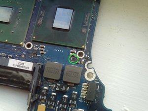

I turned my Macbook Pro (Late 2006 A1150) on the other day, everthing was going well until i tilted the screen. It caused the worn-down backlight cables to short which then fried something on the Logic board. I opened the Mac up an luckily found the broken component, however, it is so damaged that i couldn't read the code on top of it.
The part im looking for is a tiny black box with 6 pins (3 on two opposite sides).
It is on the bottom side of the logic board, to the lower right of the prossecor. below the component reads "Q9450"
(btw i did google "Q9450" and found nothing but processors)
Can someone please identify this component so i can purchase a replcaement.

just could not resist to answer this old question. I thought it might come in handy for someone else that has similar issue. The part in question is FDG6332C20V N & P-Channel PowerTrench MOSFET
