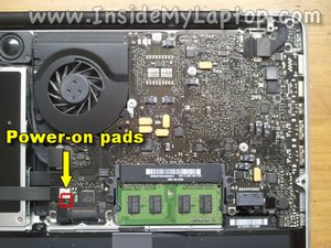

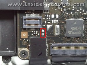

Here are the Power-On pads on the MacBook Pro (13-inch Mid 2009)
http://www.facebook.com/media/set/?set=a...
Was this answer helpful?
Score 0
Add a comment
This might help you with your issue:
http://www.insidemylaptop.com/turn-on-ma...
Cheers.
