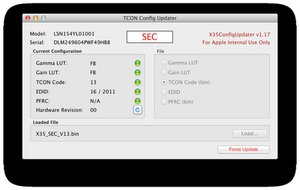

According to this article there are two LCD Panel models:
LG LP154WT1 and the Samsung LSN154YL01001
Some claim the LG version has a case of image retention, you can use the command found here in terminal to determine the LCD panel model.

I buy a MacBook Pro retina upper part, plug it on my retina MBP work fine, it cost 155$.
I want run it as a external display port display or internal, I'm search a Display controller
X35ConfigUpdater1.17 show panel info
