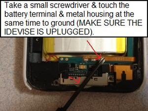

Here's a tutorial with pics that everyone has been requesting. I've used this method over a dozen times successfully. Good Luck!!
There are 3 small battery terminals (shown below). You only want to touch the one to the far right (circled below). Avoid touching the other 2 terminals!!

So I have the same problem but @Chuck H, I just gave this a shot and it was unplugged and it sparked when I tried, I then plugged it in and tried to turn it on but nothing, another guy told be that there was a short somewhere and it would be really hard to find, any input for me?
== Update ==
@Chuck
Well I tried again several times, triple checked the screen connections, even tried another screen to be sure it was the current one, but it still wont turn on, but your saying that because it sparked its not shorted right? but yeah any other ideas?
by
i just did this and the ipod came on but now it's stuck in recovery mode and it keeps telling me to plug into itunes, i have done all the resets nothing helps
by
@Malti
Sounds like your screen is fixed if you can see the usb cord plugged into itunes. You have a whole different situation going on. You have to put your ipod in DFU mode (Google DFU mode if do not know how to do this) and then plug it into itunes. Your ipod will be restored to the most current firmware from Apple.
@Jon
A spark is normal. I actually will keep contact on the battery terminal and metal until I see a spark. So your ipod is not shorted out.
1) Make sure both connectors from the screen are connected to the ipod.
2) Make sure your battery has some charge and not completely dead.
If both of these are not the problem then ground it again. Sometimes it will take 2-5 tries until it will work. Also, just plug it in and it will boot on its own...no need to hit the home or sleep button.
Good Luck to you both!!

@jon
Yes, I am saying that a spark is not an indication of a short. The only other thing I can suggest is to try and reset the ipod. Hold the sleep & home button simultaneously for 10 seconds or until you see the Apple boot logo.

Black Screen/No Response after screen replacement Fix:
I've read almost every post on this issue because I had the same thing with my ipod 4 until about 5 minutes ago. Here's what I did:
* I was grounded working on aluminum foil
If you're 100% sure you didnt tear any cables etc, and everything is connected correctly, before you 3m tape or adhesive anything:
1. I tried the ground fix of touching one end of a wire to the home button bracket and another to the 3 solder point for the battery. I got a small spark. That insured me i didnt short anything out.
2. connect the ipod to itunes with sync cable. while still plugged in disconnect the screen cable with the plastic tool from my repair kit. Itunes recognized my ipod. (you may need to hit the power button) I plugged the screen cable back in to board, and itunes stated: your ipod is in restore mode, do you want to restore the firmware. I chose yes. Itunes restored the firmware and updated my ipod. after the process was done, my ipod was working again.
by

So followed Robs advice and shorted battery, yay ipod now powers up to white screen.
Connected to itunes and pressed power button for 3 seconds then while pressing power pressed home as well for 10 seconds and got restore message on itunes.
Now downloading restore software so hopefully this will resolve all issues.
