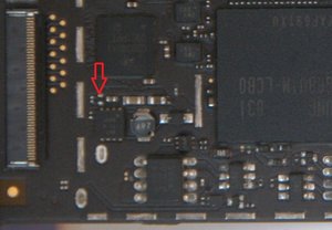

Ok here's an overview of what was wrong with my ipad...
This image is of a scrap board I had which I've removed the metal screening from. The red circle indicates the position of the short circuit capacitor (It's already been removed from the board in the pciture). Note this is the underside of the circuit board (i.e. that the side that's face down).
Its easy to check with a meter, if its short circuit then this is you problem.
This second picture shows the output from the LED drive circuit, the arrow indicates the point to test with a volt meter to confirm that the fault isn't with the voltage part of the circuit (The voltage should be around 18volts). You should be able to test this in place (you don't need to connect either the digitiser or LCD to check it), my tip is to use some pins soldered to your probes to make it easier to test.
This is the topside of the circuit board, you should be able to access this whilst the circuit board is installed in the ipad.

Hi, mark, do you have the value of the capasitator?
Is there any risk of damage any thing else, when you test the 18V .
is it nessesary to put a new capasitator, or just leave it out?
by
Sorry no value, as its connected to gound I just assumed it was for decoupling, so therefore you maybe able to remove it (but I didn't try that).
When testing the 18v just take care not to short to ground, it probably wouldn't do the circuit any good!!
by
this is an ipad 1, not an ipad 2.
by
Hi again mark, is this the ipad or is it the ipad 2 you have been reparing?
i dissasmabled the ipad 2 and i did not locate thees components.

Have just fixed an ipad with no backlight. After much work I tracked the fault to a short circuit capacitor on the logic board this held one of the gate inputs to a mosfet low and hence turned off the backlight driver circuit. I also have figured out most of the circuit for driving the LED backlight.

Wow. Your knowledge is far beyond mine since simple solutions fix simple problems and Chads problem is not simple. Mark, can you compare this to the R8 chip fix on the iPhone 3GS? Did you just replace the capacitor and backlight works again? Is it a challenging soldering job?
And please post a picture if you have of the area with the capacitor!
by
Hi good morning,
Please could put a picture or tell you where this capacitor? It is very important for me to repair this iPad, so if you can help me.
by
I have added a new answer below with pictures, hope this helps.

iPad2 Backlight chip is located here. This is the one you need to replace to get it working. I tried replacing the chips on the pix in this thread above, but didn't work.
ipad2 backlight chip location

I made a youtube video on the ipad 2 backlight solution
if your ipad 2 was short because you forgot to turn off the ipad when changing the screen.
you want to change and replace
the backlight chip
and the backlight filter
and then if you ipad had water damage change the backlight 4R7 coil as well.
for more detailed picture showing where the ipad 1, 2, 3 backlight circuits is located please visit http://www.cyberdocllc.com/ipad-2/
I have fixed more than 20 ipad 2 logicboards with backlight issues so far. I havent have one fail with this solution just by changing these three surface mount components.

I have repaired these, and as far as I can see you DO NOT need to replace 4R7. Just the other components. Yu can get them inexpensive here. parts

If your ipad 2 was dropped, there is the possibility that the backlight chip on motherboard is broken. I've had the same problem with mine and solved it with a little trick without spending a buck (and without soldering)...check the video, hope it helps :)

i dont know where diode please give me the picture to remove or change..
Was this answer helpful?
Score 0
1 Comment:
yes, if you have a known good LCD installed, then you need to replace your backlight diode.
by
Add a comment
Hey if you guys need to know where the diode and backlight filter are, we provide a free diagram for installation along with our kits. [Spam]

Also had this (once!) when changing a front glass.
The power disconnect method works but you have to be very careful not to use anything metallic.
I have seen this on laptops with b0rked CCFL/LEDs before and once actually toyed with the idea of getting an EL backlighting panel for an old 22" screen until the price list came up- $200 for a panel, although EL wire of the high brightness type arranged in line with the horizontal axis will work for those extra spooky projects :-) (about 10.6 metres for the screen I have)
The reason why that little diode is important is that with the 4R7 coil it makes a boost converter that steps up voltage to 16.5 volts for the series string of LEDs and then another component regulates the current to provide brightness adjustment.
Pretty sure that in common with other panels there is a thermistor somewhere so if the LEDs begin to heat too much it backs off the current so they don't (a) change colour or (b) fry.
White LEDs have quite a narrow range of currents where they have the correct spectra.
A good source of compatible diodes and 4R7's is old laptop LED panels which often get trashed because the glass is broken, with basic skills and thin solder this is an easy though fiddly repair.
