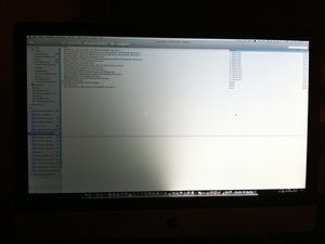

Hello,
since 3 days my display is in the left corner much dark than anywher else and sometimes it's flickering. But only the backlight turns on and off. I don't have any problems with the display.
I think my LED backlight or the backlight board is defective. Our local Apple Service Provider made a quotation: display-change 670€ -that's to much. Since 2,5 month I don't have any warranty. :((((((
Is it possible to replace only the LED backlight?? What can i do to fix it?
Today I changed the backlight board trying to fix my problem. And: Nothing changed. So I think the display itself is the problem, but an exchange would cost too much.

Hi Jose - how old is your Mac? When did you buy it? Is it a 27" ?

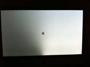

Same problem here...
Couple of nights ago when working late suddenly the screen on my 27” iMac went dark on the left side of the screen. Not completely dark… but maybe 20-30% darker. I watched it happen… very scary !
Waited couple of minutes and turned my iMac on againg… and the screen was bright as ever.
Next day - happened again.
Today… well - haft the screen is okay. The other - left side - belongs to the Dark Lord.
If I turn off the computer and let it rest for 15 minutes… it’ll be okay for some time.

Im getting the same problem right now, my iMac 27" screen has shown slight signs of brightness flicker, and today I noticed the one side seems a bit darker and suddenly it went a lot darker. Atleast its only 4 months old so it has a warranty so they should fix the problem I hope...oh there goes another flicker to full on bright and right back to the darkside..SUUUCKS

Hi all , it is possible to repair = solder left side backlight connector inside lcd . We repairing it at daily basis .... MiB , Maczone.cz

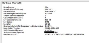

I don't have warranty because I bought it in december 2010. I called with the german apple support and they also said "my warranty is expired". Unfortunately I bought no Apple Protection Care because I thought it's a 2000€ machine and should work at least some years without any troubles. Now I know better.
by
Please give the last three letters of your serial number as I think you have the wrong machine listed. Also if it was bought in December of 2010, it's still under warranty.
by
The last 3 numbers are "5RU". Sorry I made a mistake. I bought him in december 2009. Sorry
by
OK, it's the i5 not i7
Apple iMac "Core i5" 2.66 27-Inch (Late 2009) Specs
Identifiers: Late 2009 - MB953LL/A - iMac11,1 - A1312 - 2374
by
No, its a i7 Late 2009. Look at the screenshot!

I found that the problem is one connector on the back of the LCD-LED panel that is loose and therefore not transmitting the power to the LED lights on that zone of the screen.
I fixed mine by removing it and soldering some wires directly to the screen board.
You have all the info here: https://discussions.apple.com/thread/404...

Son had the same problem with his 27" iMac,
One of the easiest repairs I have ever done,
perhaps excluding getting all the way down to the problem.
The problem is "cold solder" joints, I.E. the joint crack from stress, age and heat.
A quick touch of the solder iron, back to original.
You need to get the display out, peel the tape off, (keep track of it)
a few screws and some latches will remove the bezel.
Be careful at this point as you are now into some component that should remain clean and the actual display screen is easily cracked or damaged.
Once you are all the way disassembled, you will see where the 6 or so (on each side) wires go into the back, on the bottom on either side. From the front you will see the connector that these wires connect to the led "back light" boards,
Have some one experiecned with solderting, watch the heat!
reflow the solder joints and reassemble.
Enjoy your like new, trouble free display.

I've had my 27" iMac dissembled... to see if I could find the cause... the cold solder joints. No luck. iMac is from december 2009. Problem occurred aprox 1 1/2 - 2 years from purchase. I've learned to live with the left-corner-dark-spot problem... even though it's annoying. Most of the action on the screen happens on the right side... iTunes in the dark spot - even added a ssd disk and filled it up with ram (one of the ram slots didn't work by the way) - to breathe an extra year of life to my soon ancient iMac. I will however buy a new one probably within the next year... and cross my fingers not running into any dark spots again.
