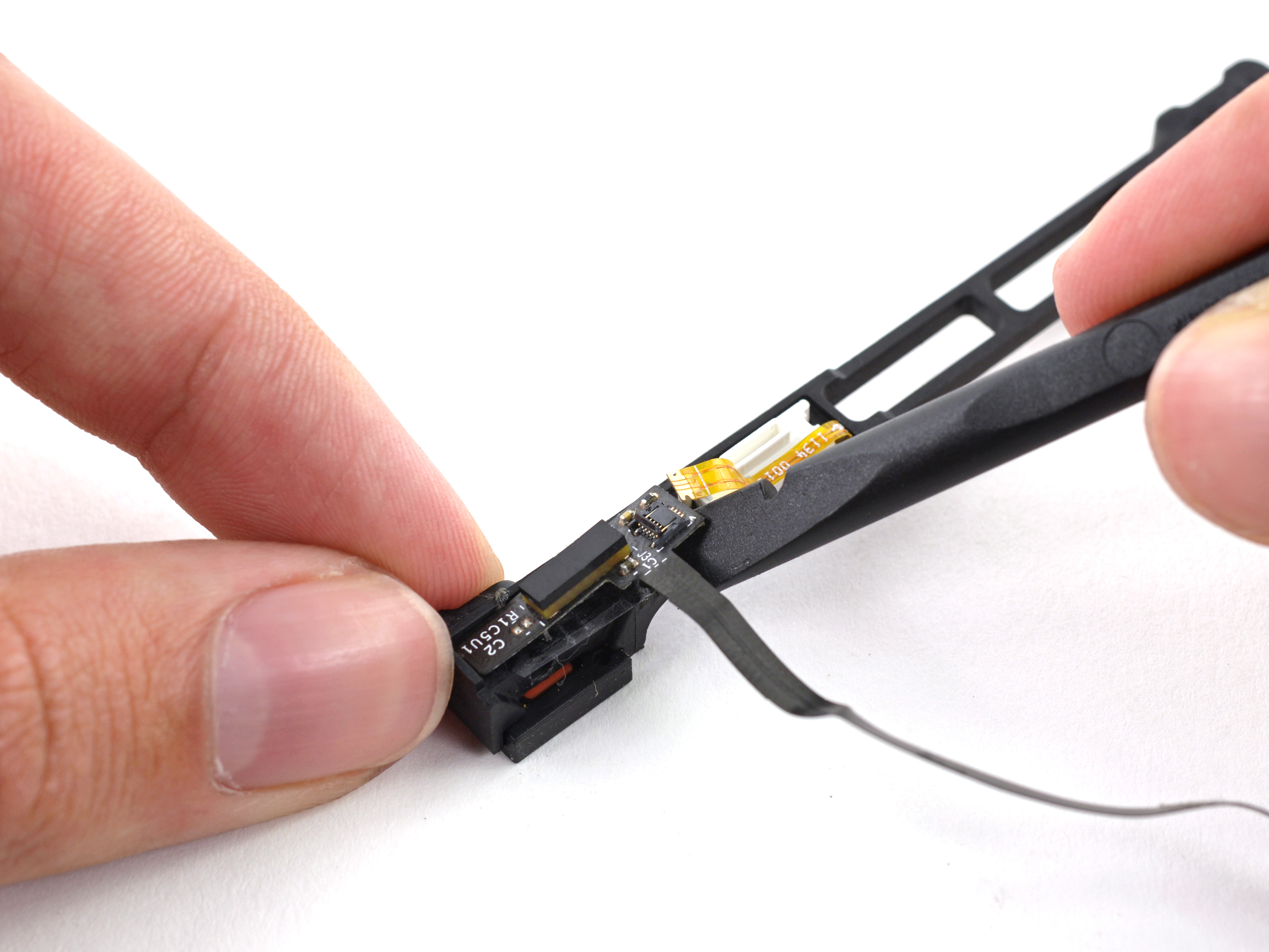

The hardware cause is either the magnet was not correctly located when the screen was replaced or the Hall sensor is going bad. Rare earth magnets don't loose their magnetism on their own so thats not the problem.
In this case the sensor could be the issue, follow this IFIXIT guide: MacBook Pro 15" Unibody Early 2011 Hard Drive/IR Sensor Cable Replacement. You'll want to get the full cable assembly as the Hall sensor is part of the cable. Here is the part you want: MacBook Pro 15" Unibody (Mid 2012) Hard Drive Cable - Apple P/N 923-0084. This is the newer version of the cable which is what I recommend.

The Hall sensor within the system can loose its ability to sense the lid magnet. Yes, a stronger magnet might work as you have shown when you put it over the sensor location. Its still a bad sensor Vs a magnet that has lost its magnetism. Unless you put the system {lid magnet} though a very powerful demagnetizer did you? ;-}
As reference the Hall sensor is the large rectangle seen in this image: Hall sensor and here's more from Wikipedia: Hall Effect
by
OK, I will try to change the Hall sensor, but thing is, I still don't understand where the Hall sensor is located. Is it on the opposite side. ;) Tks for helping me to understand.
