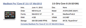

I bought this Macbook Pro 13" Unibody Mid 2012 secondhand less than a month ago. It is my first Mac computer. After a few weeks of checking it out, I realized it has two USB 2.0 ports. I check everywhere there is to check and apparently it is supposed to have two USB 3.0 ports.
I have carefully checked which model of computer I have and it seems that I have the right computer, but only these ports. This is how I checked which model I have.
Here's what I know:
  • Model Identifier: MacBookPro9,2
  • Model No.: A1278
The problem is that even in this page of Apple's website it seems to be that every "Mid 2012 MacBook Pro" is supposed to have these USB 3.0 ports as it is one of the upgrades from the previous model.
I have been wondering wether if it is a setting or something I'm ignoring or maybe there is a way it can be changed somehow (I really do not think so, as these chips are part of the logic board).
The question is, what can I do? Of course, I would like to have the best specs on my computer, specially if the manufacturer uses these specs to sell it.
I appreciate all your help.

Are you sure you have the correct model? The older 2011 Mid & Late models have USB 2.0 ports.
The USB ports should be Blue in color. If they are black then you have a 2.0 logic board which may have been installed in a newer models case.
Double check the serial number under About This Mac ... paste it into here: EveryMac what does it show you?
Update (02/13/2016)
This gets a bit confusing as Apple and the others have reverted back to the Black/White outlets in the newer systems! As people complained about the look of the Blue.
So you can't just look at the outlets color alone. The marking above the ports is different it should have SS then have the USB bug.
The SS denotes the 5Gbps data-transfer rate of USB 3.0. SS and 10 denotes the 10Gbps speed of USB 3.1
The systems you see at the Apple Store's are USB 3.0 ports.
You'll need to review the hardware profile section under About This Mac ... > System Report ... > USB to see what the bus is (USB 2.0 or USB 3.0) for the given system MacBook Pro retina models & MacBook Air models.

I'm obviously a little late to this party, and I assume the OP has determined the answer to his questions by now, but I'll post this for anyone else who stumbles across it in the future.
Neither the markings nor the color of your mid-2012 MacBook Pro USB ports matter. They are 3.0 ports, which you can check on using System Profiler. However, connecting a 2.0 device will configure them as 2.0 ports and connecting a 3.0 device using a 2.0 cable will do the same. Use the link below to read all the details.
Definitive answers about Apple USB ports and troubleshooting can be found here - https://support.apple.com/en-us/HT201163

Old thread, but I was looking at system profiler while having a WD passport USB 3 drive connected, I noticed that the USB list is scrollable and the drive was listed as 3.0, whereas the keyboard and track pad were on the 2.0 bus.

I got the mid-2012 non Retina MBP 13" too, and after running System Identifier (to check if all my 16 gigs of RAM were recognized) it also seemed to have two USB2 ports only.
However, TechTool Pro 8 told me that the USB ports were running at 5 gigabit/sec which means they comply with the USB 3.0 standard.
