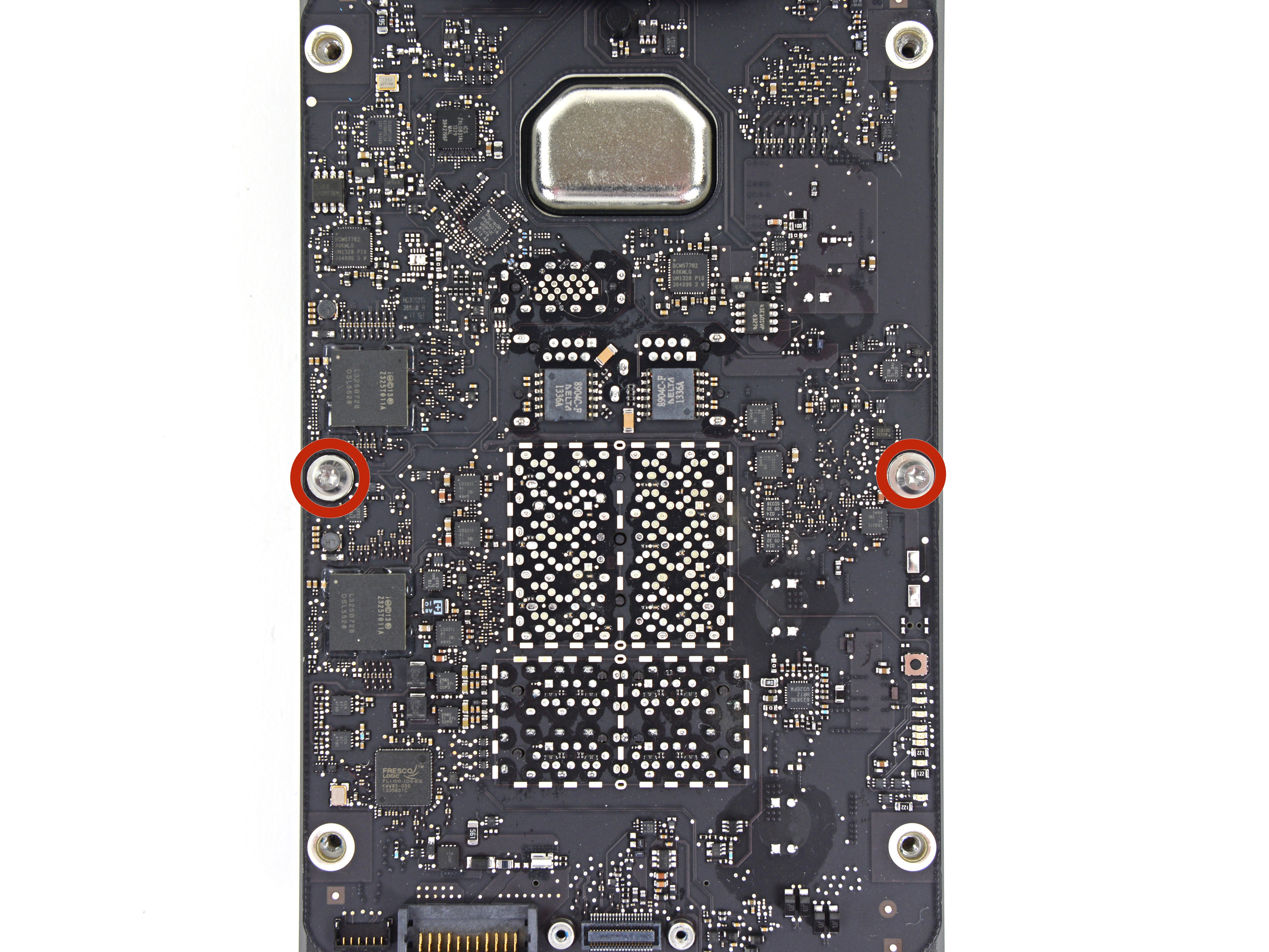

Not on the market yet... but they were demoed. They may never be out in the market. My question is concerning the hdmi port on the new Mac Pro. Can it be upgraded? Apple has claimed that the hdmi port (1.4) on the new Mac Pro can support 4k displays but my concern is at what frame rate. (30 or 60) It is my understanding that hdmi 2.0 is an improvement. (Can play video at 60 frames per second.) So again, Can the HDMI port on the Mac Pro be upgraded from 1.4 to the "new" 2.0 standard.
As to upgrading its too soon to say what Apple will do. HDMI 2.0 is so new I don't know of any system currently on the market that has support for it. As the signal processing hardware is what is being improved Apple would likely need to release a new logic board (which would be no different for any other system). Bottom-line here is you are way ahead of the curve.
by Dan
So, you buy a new Mac Pro for 4 to 5 grand today and it is already basically obsolete. What a deal? This was the future according to Apple. Not. If HDMI port can not be upgraded easily (Firmware update or a simple module replacement).
by rtrutter
Hold on here! I don't think it's as bad as you are thinking! First the Mac Pro is very modular, so only the I/O board will likely need replacing and maybe some firmware: I/O Board. You also have to remember Apple is not the only one thats behind the eight ball here all of the hardware vendors are. Until a standard is ratified and the needed components are even available at the levels needed for production it's just speculation when a new standard will be made available.
by Dan
HDMI 2 was adopted September 2013. CES 2014 demoed this in January 2014. I wonder how much this I/O Board will cost?

Don't stare yourself blind on HDMI 2.0 since the HDMI-signal is on the same bus as the Thunderbold 2 signal which already supports 4K 60fps.
Second, electrically, HDMI 2.0 is exactly the same so a firmware update should be enough.
Don't forget that HDMI is originally designed for DRM. So in the end you are better off buying an adapter (TB to HDMI or DVI which is the same without audio) and use an optical Toslink cable for audio which gives the ultimate quality since it is optical.
So, to conclude that the Mac Pro 2013 is obsolete due to a connector-type is rather silly to put it mildly !
