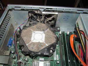

Hello iFixit, I have another machine I was given to keep, and for the most part, I got it cleaned up nicely
Here's what I did so far
  • Cleaned the dust
  • Cleaned the fan
  • Blew the power supply out
  • Cleaned the heatsink dust out
  • Cleaned the heatsink fan
  • Cleaned the CPU thermal paste
But that's where things are becoming an issue
I cleaned the heatsink and it was fine, but I am now having issues
The thermal paste is so dry because of the dust in the cooler was blocking so much airflow, it's as dry as you can get(!!!)
Here's how dusty it was, and why I know this is dry TIM on the heatsink
I got the CPU cleaned up, but the heatsink just won't clean
Here's how nasty it was, and why I am having trouble, because this dust dried out the TIM

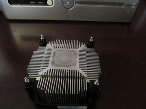

Any ideas to get this cleaned, because I am out of ideas; I tried IPA on a napkin pressed to the heatsink with a tape dispenser to give weight, pouring it straight on and letting it soak, and windex and it's still not entirely removed for repasting
This is what I have left on the heatsink for reference

Have you tried applying *new* thermal paste and letting it sit for a few hours, covered, before wiping it off? It's counter-intuative, but a method that works to remove many things (use adhesive to remove adhesive, use marker to remove marker, etc.).

Do you have access to a ultrasonic cleaner and the ultrasonic cleaning fluid (waterless)? You could give that a try since you have it out.
