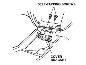

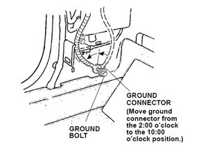

How do I replace my cigarette lighter on my 2002 honda accord.
i own a 2002 honda accord and i need to take out and replace the entire cigrette lighter. can you pleas tell me how i can do this. thanks you

13. Loosen the ground bolt and move the ground connector from the 2:00 o’clock to the 10:00 o’clock position. Retighten the ground bolt.

22. Attach the cover bracket with the two self-tapping screws.
23. Reinstall the driver’s dashboard lower cover.
24. Plug the 4-pin connector of the cigarette lighter harness into the front ashtray with cigarette lighter; then push the four retaining clips of the front ashtray with cigarette lighter into the holes in the dashboard.
25. Secure the front ashtray with cigarette lighter with two self-tapping screws.
