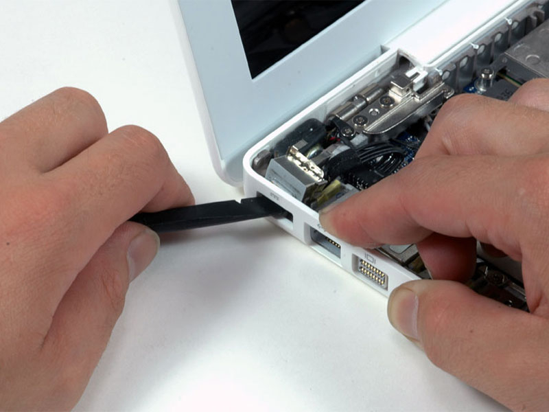

  13. MacBook Core Duo MagSafe Board Replacement, MagSafe Board: step 13, image 1 of 1
    • Remove the single Phillips screw securing the MagSafe board to the lower case.
  14. MacBook Core Duo MagSafe Board Replacement: step 14, image 1 of 1
    • Use a spudger to rotate the MagSafe board up and out of its housing. It may be helpful to pull the lower case out slightly to provide additional clearance.
  15. MacBook Core Duo MagSafe Board Replacement: step 15, image 1 of 1
    • Disconnect the MagSafe board from the logic board.

Before you do this - might be worth checking to see that the insulating gasket in the magsafe port is intact. I was about to buy a new board when I noticed that the gasket was broken (I wouldn’t have noticed there was even a gasket unless it was broken).
Turned out for me it was just this insulating gasket in the outside of the port that was stopping it charging and I didn’t even need to open the back. When I found part of it still intact, I guessed partial insulation might be that causing a short. The gasket is made of very thin tape and sure enough when I made a copy and put that in, it charged fine on the new charger I had bought. The old charger is dead (on this and a friend's machine) so I presume it was fried shorting while I repeatedly tried to charge before. P.S. I made the copy by making an inverse template by pressing Blutac into the port and used that as a block to print an outline onto the tape.
Sally-ann - Reply
“Turned out for me it was just this insulating gasket in the outside of the port that was stopping it charging and I didn’t even need to open the back. When I found part of it still intact, I guessed partial insulation might be that causing a short. The gasket is made of very thin tape and sure enough when I made a copy and put that in, it charged fine on the new charger I had bought.”
INDEED!!! That was the same case for my macbook! the plastic film on the charger port was partly broken. I took off the rest of that broken film with a pin, then I cut out duct tape to fit and place around the pin connections, and that did the trick!!
