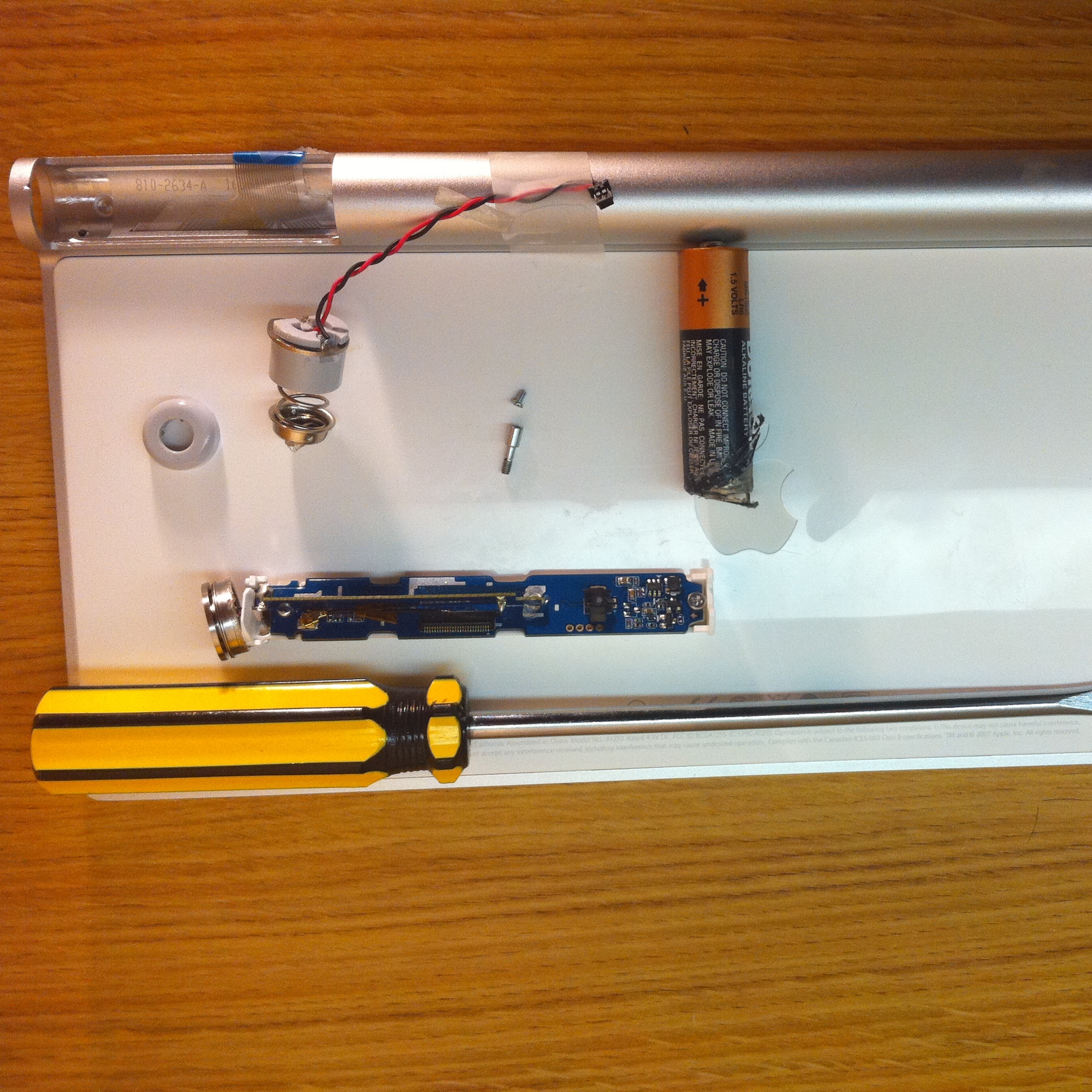

  • Answer to: Batteries corroded & stuck inside Apple Wireless Keyboard (Aluminum)
    its called a lock ring too you can find in a engine repair shop. I have the tool, but the teeth were not long enough to reach the holes on the lock ring. here is an alternative 1. Get the longest screwdriver you can find, that can touch the battery and still have length showing once you put the screwdriver in the battery well. any type of tape, to tape down the wires. 2.remove plastic cover it will pop off once glue is removed. there is only 2 screws holding down the electronic board. remove the first screw, 2a, bend back slowly the soldered part that you just removed the screw from, 2b, unscrew the post. 3.there is a piece of tape the is covering the wiring lock to the circuit board. remove tape, unclip the plastic lock and pull circuit wire from the back of the board ( similar to Ipod,Iphone connection) and push the circuit board towards the button you use to power up the keyboard. slide slowly, the battery connection is attached. once you see the connection take it off with your nail or screw driver 4.slid...
