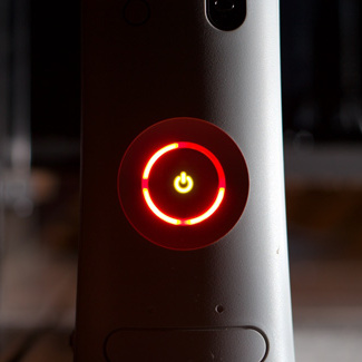

Answer to: X Box 360 turns on but freezes on logo
System freezes on the console are a bit complicated. It could simply be the starting signs of the Red Ring of Death or a bridge under one of the ram chips. The system will need a proper reflow job done to it to fix your issue. -
