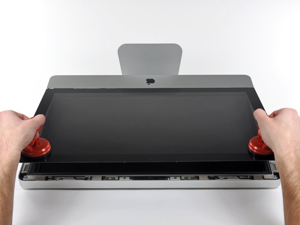

Get a heavy-duty grip on heavy-duty glass.
  • Large glass panels rarely come with handles—use these suction cups to safely lift and remove glass from LCD screens.
  • Ideal for gaining entry into iMacs and glass-sheathed laptop displays.

As devices get thinner and lighter, designers are running out of places to put simple repair access ports. Increasingly, they are dual-purposing the LCD of a computer as the access point. With just a flat, featureless piece of glass as your entry port, you need suction for a safe grip.
