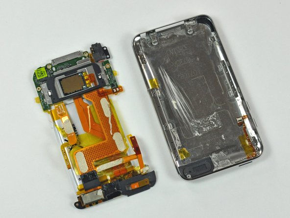

    • Let's get the logic board out...
    • We're skipping a few of the details, so don't use this to take apart your touch.
  8. iPod Touch 3rd Generation Teardown: step 8, image 1 of 1
    • It's out!
    • You can see the speaker sitting on top of the logic board.
