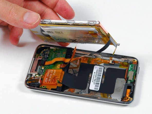

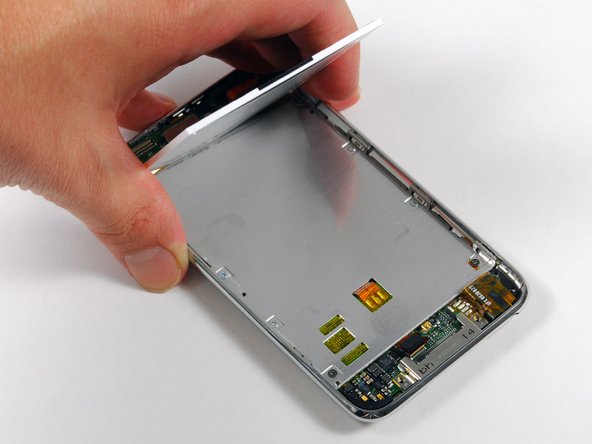

Add Note Edit Step 7  ¶
  • Removing the metal backing.
  • The battery is held to the backing with two strips of light adhesive, but peels off easily.
first image

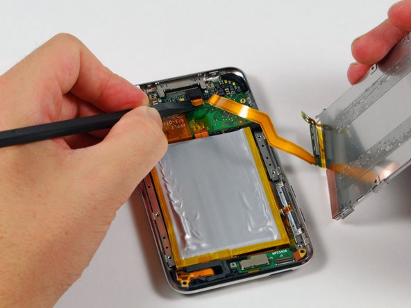

Add Note Edit Step 8  ¶
  • Disconnecting the display data cable.
  • Note the residue from the glue holding the battery to the metal backing.
  • This is getting exciting!
first image
Add Note Edit Step 9  ¶
  • Removing the battery.
  • The WiFi antenna and circuitry are at the bottom of the image, near the thumb.
