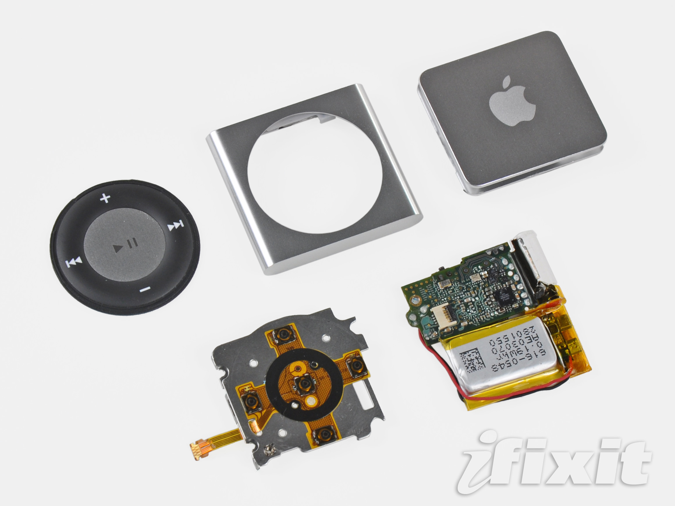

    • Although this step makes it look super-simple to open the Shuffle, it's not. It took us a good half hour of prying and heat-gunning to open the little guy.
    • Pro tip: Aluminum gets hot when it's heated!
  5. iPod Shuffle 4th Generation Teardown: step 5, image 1 of 1
    • The exposed internals.
    • The logic board is stuffed alongside the battery in the outer case.
    • Notice the glue residue along the edges of the opening.
    • Apple press-fit and glued the back clip onto the body. No wonder it was such a doozy to open!

    • We remove the logic board and battery together from the iPod, because Apple once again chose to solder the battery to the logic board.
    • The loss of user-serviceability is the price we pay for small, sleek design.

    • iPod Shuffle 4th Generation Repairability: 2 out of 10 (10 is easiest to repair)
    • Good: The control pad is attached to the logic board via a connector, allowing it to be easily separated.
    • Good: The lack of a screen eliminates a large weak point of other devices, making the Shuffle more resilient to falls. Just don't flush it down the toilet.
    • Bad: You essentially have to break it to open it.
    • Bad: The battery is soldered to the logic board, making replacement that much more difficult.
    • Bad: Apple keeps shrinking connectors. These super-small cable connectors are increasingly difficult to open without breaking them.
