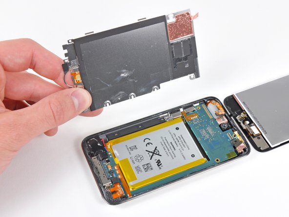

Add Note Edit Step 8  ¶
  • There's an EMI shield between us and the iPod. Fortunately, it's just held in place with a few Phillips #00 screws.
  • The EMI shield is surprisingly heavy, weighing in at 11 grams. The entire iPod Touch is only 101 grams, meaning Apple has devoted more than 10% of the iPod's weight to this metal EMI shield.

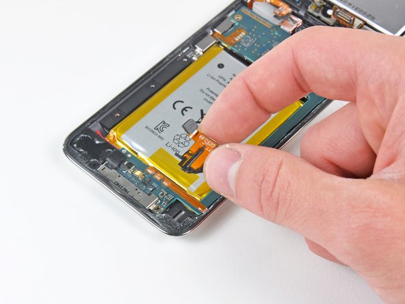

Add Note Edit Step 10  ¶

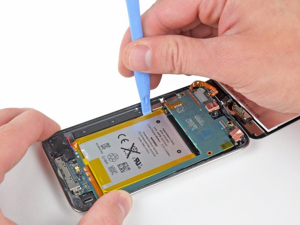

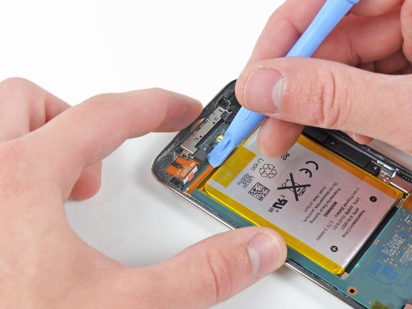

  • The battery lists a capacity of 3.44 Watt-hours.
  • Like all other revisions of the iPod Touch, the battery is soldered to the logic board. This isn't a surprise given the slim form factor of the iPod, but we wish Apple would make battery replacement easier.
  • Fortunately, compared to the 3rd Generation Touch, Apple did add more space between the battery's three solder points (on the orange ribbon just to the left of the battery). This should make the soldering job a little easier when replacing the battery, as there's less chance of accidentally bridging the contacts.

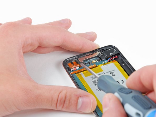

Add Note Edit Step 11  ¶
  • In a first for the iPod Touch line, the headphone jack is not soldered to the logic board.
  • One screw, one connector, and the headphone jack lifts out.
  • Having the headphone jack on a separate board is definitely a plus for repairability.

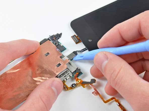

Add Note Edit Step 14  ¶

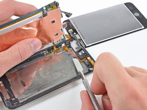

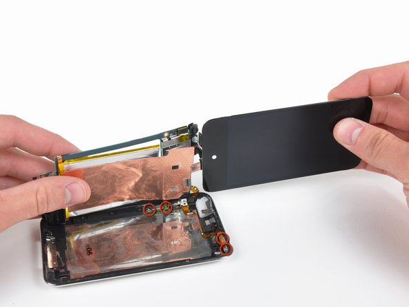

  • After wrangling the logic board/battery/display assembly out of the rear panel, we can finally access the screws holding the volume button cover and the sleep button down.
  • After a good bit of anxiety-filled scraping with a metal spudger, the ribbon cable is finally free from the rear panel.
    • The control ribbon cable is bonded to the rear panel extremely well, especially near the volume buttons. Since the volume buttons have no structural bracket (just a steel cover) holding them to the rear panel, the adhesive bond must be strong enough to survive presses from the strongest of button pushers.
Image #1 Image #2

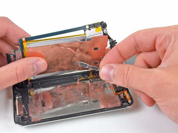

Add Note Edit Step 15  ¶

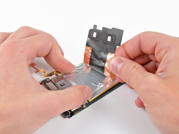

  • After removing a loop of copper tape around the digitizer connector, the display assembly can finally be separated from the logic board.
  • A copper shield fastened to the back of the battery can also be removed at this point.
    • Presumably, the rear case is thin enough to warrant a copper shield for either heat dispersion or EMI protection, or both.
Image #1 Image #2

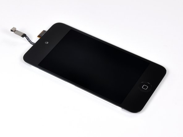

  • The display assembly of the Touch measures 2.93 mm thick. That is slightly thinner than the 3.05 mm iPhone 4 display, and 30% thicker than the 2.27 mm display on the new iPod Nano.
  • The retina display on the 4th generation Touch is rumored to be lacking IPS, differing from the display installed in the iPhone 4. A way to test the difference is to examine an identical image on both devices at an extreme viewing angle. As seen in the second picture, the Touch (bottom) loses a great deal of contrast when viewed from a low angle.
