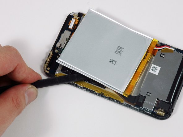

Add Note Edit Step 8  ¶
  • We got it apart! We used a metal spudger. There are metal tabs along each side of the iPod.
  • The iPod Touch doesn't need a large speaker or microphone, so the battery occupies a larger portion of the internals than the iPhone's battery.

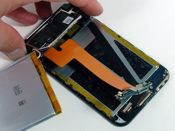

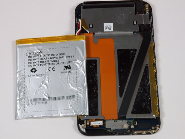

Add Note Edit Step 10  ¶
  • The large battery is soldered to the logic board, like the iPhone and many of Apple's recent iPods.
  • The battery is very flat and thin.
Image #1
Add Note Edit Step 11  ¶
  • The huge touch-display lies beneath the battery.
  • The logic board is beneath the metal shield at the top of the image (under the 2D barcode).
  • The Touch battery is 54.0 x 64.1 x 2.8 mm, while the iPhone battery is 43.6 x 50.5 x 5.4 mm. That puts the volume of the Touch battery (9588 mm^3) at 81% that of the iPhone (11780 mm^3).

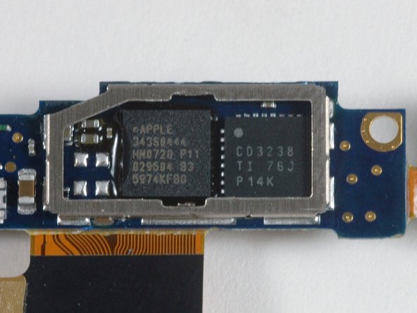

  • We rotated the logic board up, and we're using a spudger to pry up the PCB underneath the logic board. This board probably houses the components for processing touch screen input.
  • You can clearly see the Foxconn stamp on the dock connector. Apple has used Foxconn extensively to assemble their iPod line.

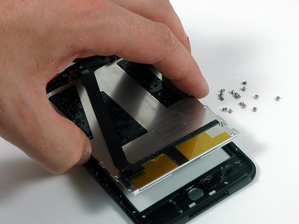

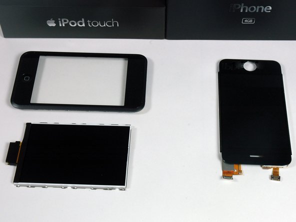

  • Removing the display from the front bezel. The display attachment is completely different from the iPhone.
  • The display is attached to the front of the iPod by 16 Phillips #00 screws. On the iPhone, the display and front bezel are fused together with very strong adhesive which makes it impossible to separate the display from the front glass.
  • This design will be very nice for repairs, as removing the display is very doable. The LCD just comes right out after you remove the screws.

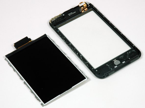

  • The touch-screen LCD on the left, and display bezel on the right.

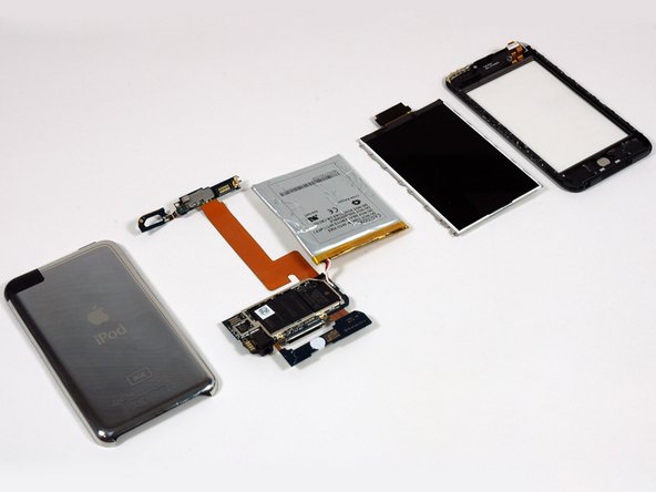

  • The iPod touch internals.
  • Apple has integrated a lot of components into the logic board assembly on this iPod. This iPod sports only five main parts, held together by lots of tabs, adhesive, and 22 screws.

  • Left: iPod Touch front bezel and LCD. Right: iPhone LCD and integrated bezel.
  • The difference in display assemblies between the iPhone and iPod Touch made us wonder if the Touch uses a glass front like the iPhone. After seeing no official word from Apple, we resorted to a scratch test. We used a key to scratch the front of an iPod Video, iPod Touch, and iPhone. We're happy to report that the iPod Touch came out completely unscathed, while the iPod Video received a large gouge on its plastic front.

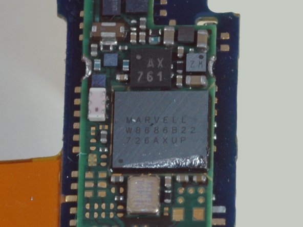

  • This is a Marvell W8686B22. The Marvell W8686 family is a 802.11a/b/g WLAN system-on-chip. The iPhone has a W8686B13, which is likely a very similar part.
  • We did not find the CSR Bluetooth chip that the iPhone has. However, there are several Apple-branded chips that we didn't identify, so we cannot completely rule out the presence of a Bluetooth chip.
  • From what we are told, a Bluetooth antenna (if it existed) could be integrated into a PCB like this one, making identification difficult. The 'RF1UB' marking on the back of the board indicates that it's been designed for RF, and probably tested at frequency. So, while we don't see evidence of a Bluetooth antenna, we cannot rule out its existence.
  • To make it perfectly clear: We cannot confirm nor deny the presence of Bluetooth in this device.
