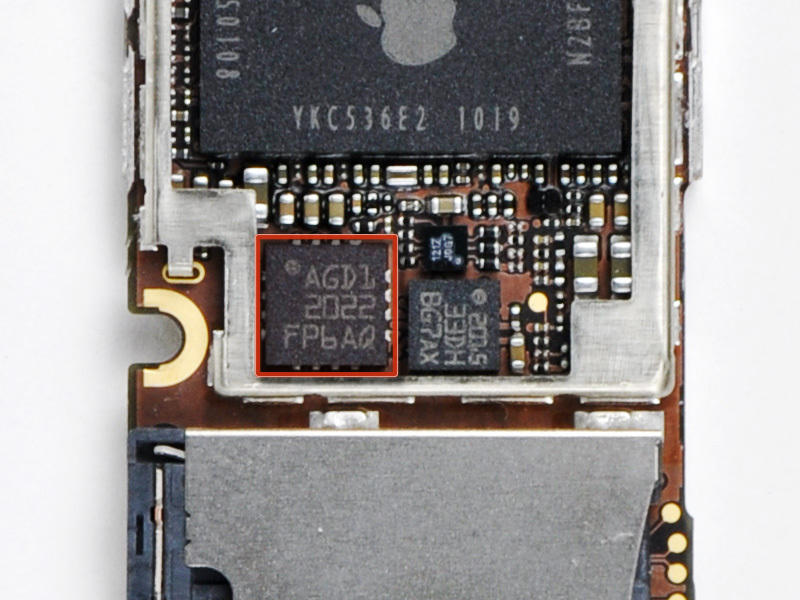

  2. iPhone 4 Gyroscope Teardown: step 2, image 1 of 1
    • A microelectromechanical system (MEMS) is an embedded system that integrates electronic and mechanical components at a very small scale.
    • A basic MEMS device consists of an ASIC and a micro-machined silicon sensor.
    • The AGD1 2022 FP6AQ chip found in the iPhone 4 is a MEMS gyroscope rumored to be designed by STMicroelectronics.
