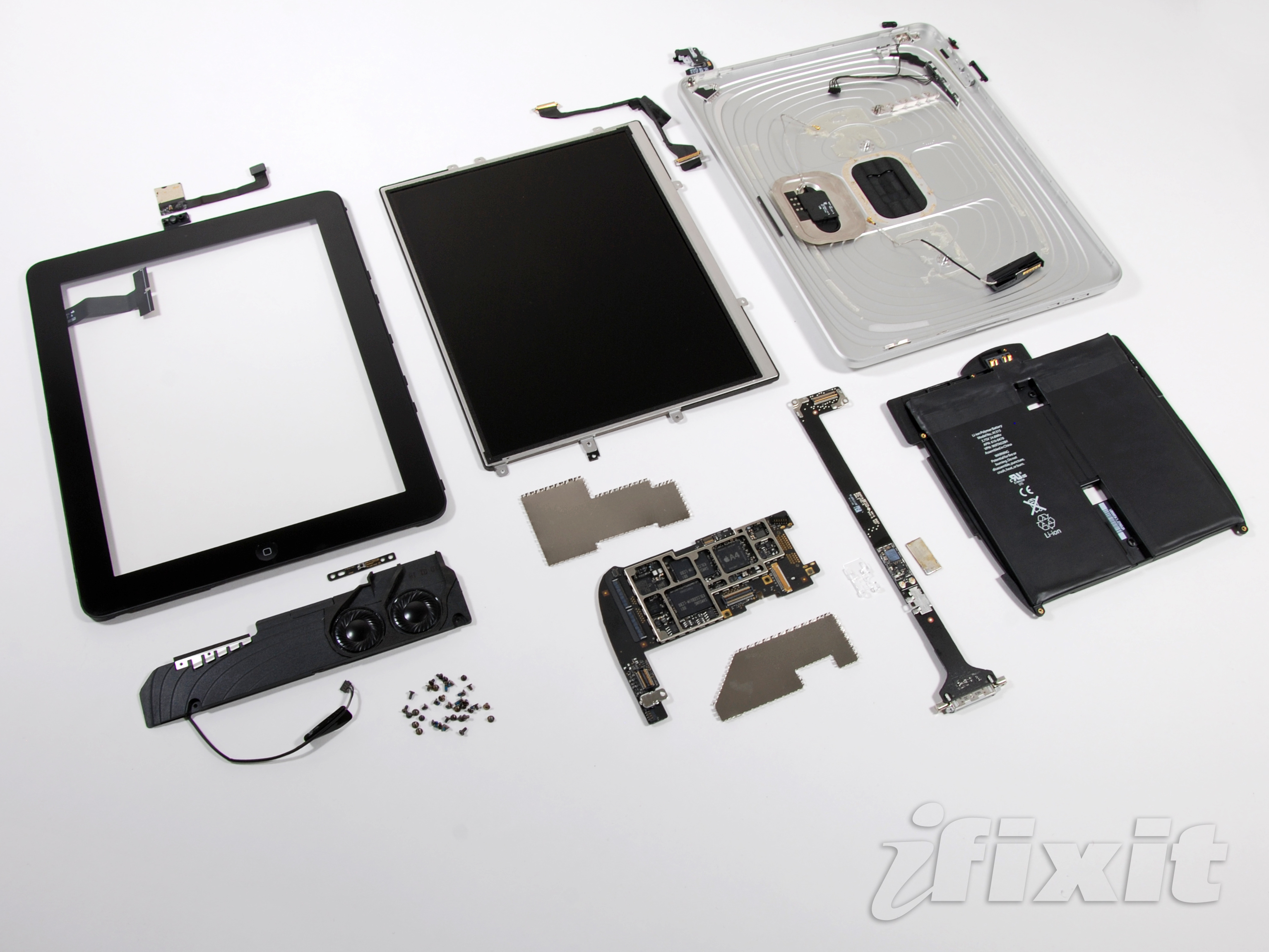

  31. iPad Wi-Fi Teardown: step 31, image 1 of 1
    • As always, the final layout shot.
    • Here's the weight breakdown: Aluminum back: 138 grams, Battery: 148 grams, LCD: 153 grams, Glass (and frame): 193 grams, Speaker: 17 grams, Main board: 21 grams, Everything else: 27 grams
    • Total: 697 grams (that's more than the .68 kg Apple quotes, has anyone else weighed their complete iPad?)
    • This iPad may be apart, but we'll continue to dig deeper into its chips. Follow @ifixit for the latest updates!
