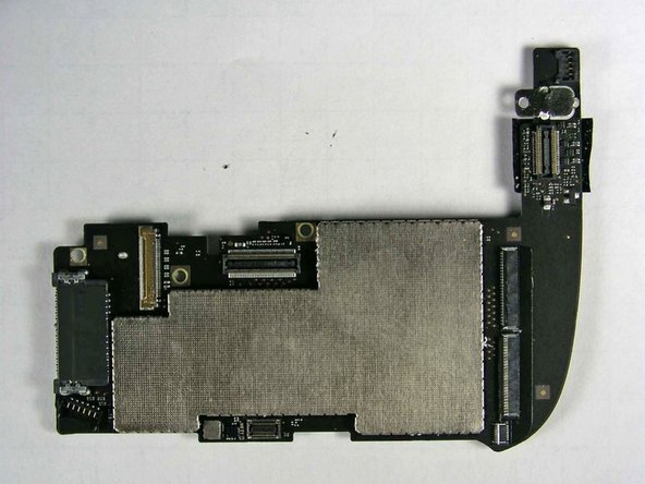

  • Performing analysis as we go. Please help out in the comments! To see highest resolution files, log in and you'll get a large option on each photo.
  • One word of caution: This is likely a preproduction board, and Apple very well may have changed some suppliers since they gave the FCC a sample unit. Take this data with a grain of salt until we are able to analyze a production model tomorrow.
  • It looks like there is a LOT of epoxy holding these chips down to the board. More than we've seen before— Apple is really serious about durability on this thing.
  • 2x Toshiba Flash
  • Apple A4
  • Broadcom BCM5973

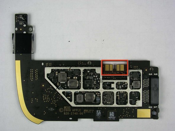

  • Bottom of logic board, with and without the EMI shield.
  • We're very happy to report that Apple didn't solder the battery! The iPad uses the same battery attachment system as the iPhone 3G and 3GS.
  • It looks like this board was made by AT&S. It will be interesting to see if their marking remains in the final production board. We haven't seen Apple's PCB manufacturers brand their boards before.

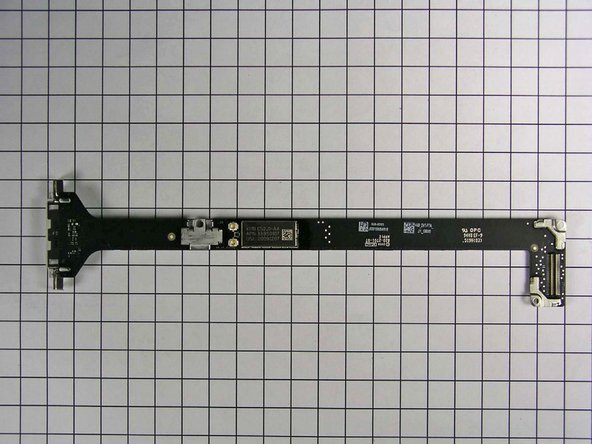

  • This cable carries the signal from the dock connector to the logic board.
  • Never one to waste space, Apple also managed to tack the wifi and bluetooth boards onto this cable.
  • Like some other Apple devices we've seen, the home button is low-tech. There's two contact points that mate with pads on the display assembly. When the button is pressed, the circuit is completed.
  • Notably lacking from this RF/data cable is anything GPS related.

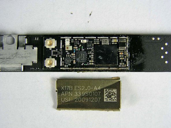

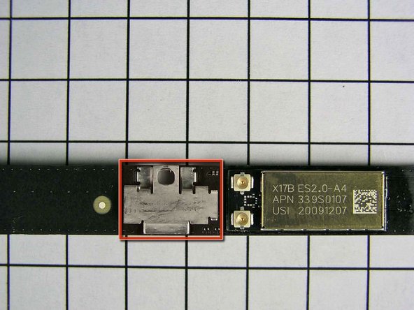

  • Wi-fi and Bluetooth are integrated into a single board. Broadcom has been one of Apple's favorite suppliers recently. It's possible this is the same BCM4329 chip that Apple used in the 3rd Gen Touch.
  • Laser engraved on the cover:
    • X17B ES2.0-A4
    • APN 339S0107
    • USI 20091207
  • The bracket shown in the second picture is both a cable clip and a ground point for the WiFi/Bluetooth/cable assembly.

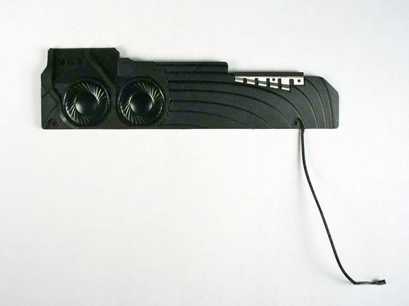

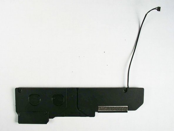

  • A shot of the speaker assembly.
  • The dual speakers provide mono sound. Two small sealed channels direct sound toward three audio ports carved into the bottom edge of the iPad.
  • The connector found on the speakers and other components is typical of the connectors seen in MacBook Unibody laptops. Translation: the iPad isn't that cramped for space.

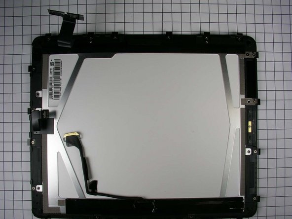

  • The inner side of the display assembly.
  • The part number is hard to make out, but it looks to be LP097X02. If that's correct, then the display is made by LG-Phillips.
  • This is very likely the most expensive part of the iPad. It uses expensive IPS (in-plane switching) technology and is LED backlit (as opposed to the cheaper TN and CCFL backlit).
  • Display LED barcodes: 1579CN7346569 3225 LG0NJ 'GK65284221MTA', and 5091L-0942B 091214 R51 K319CED5D61R0094B2

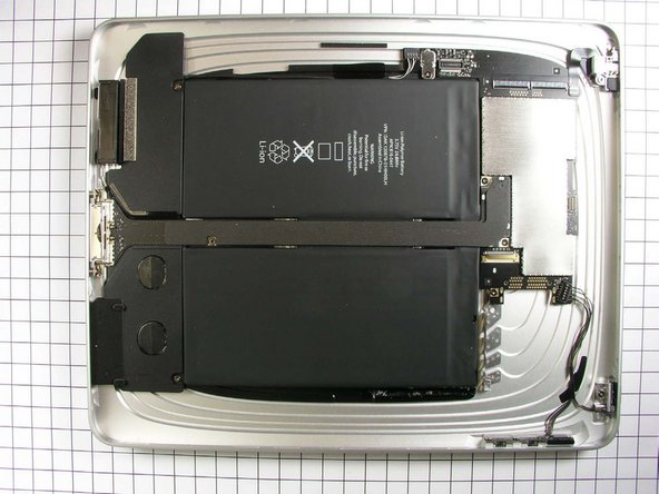

  • The battery is quite obvious to pick out of this picture of the rear case (sans display assembly).
  • The 3.75V, 24.8 watt-hour (6.5 Amp hour [!]) battery provides the juice for an advertised 10 hours of use. In contrast, the iPhone 3GS has a 4.51 watt-hour battery and the MacBook Air has a 40 watt-hour battery.
  • The battery seems to integrate two separate 3.75V lithium polymer cells wired in parallel for such ample battery life.
  • The USB power supply had to be enhanced specifically for the iPad. It's a 10W unit manufactured by Foxlink Technology, Ltd., part #A1357 W010A051.

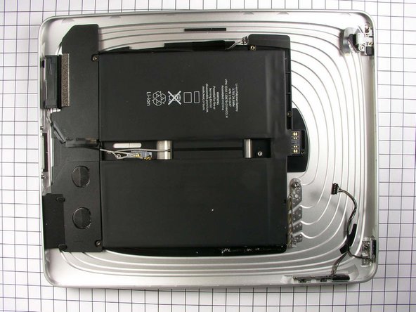

  • Some other markings on the battery:
    • APN: 616-0447
    • VPN: DAK 120670-01HH00LH
  • The small black box in the second picture is one of the WiFi antennas.
  • Hopefully the WiFi reception will be decent, as the back of the iPad appears to be a single block of aluminum. In addition to the antenna mentioned above, the Apple logo in the center of the rear case also serves as a window to allow for the transmission/reception of RF signals. We saw Apple do this on the newest iMacs.
