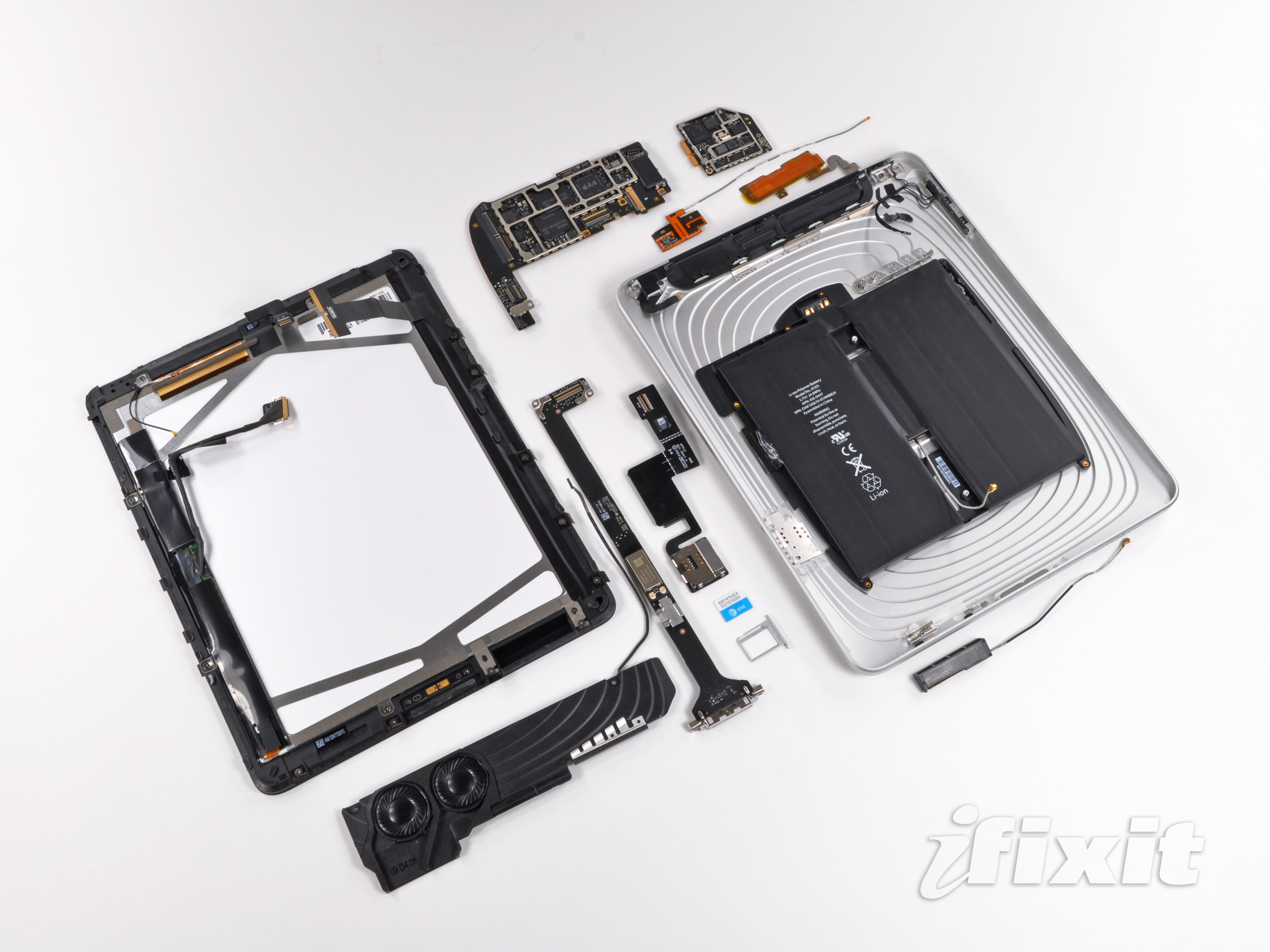

  • The much awaited iPad 3G is finally in the hands of iFixit!
  • The Wi-Fi + 3G iPad. We got a sneak peak of the internals of this tablet a month ago by poking around on the FCC's database.
  • The 3G iPad is visually distinguished from its Wi-Fi-only sibling by a black plastic RF window.
  • The 3G iPad supports UMTS/HSDPA on 850, 1900, and 2100 MHz and GSM/EDGE on 850, 900, 1800, and 1900 MHz.
  • In a dramatic shift for Apple, the iPad is unlocked, and not tied down to a specific carrier.
  • Alas, in the US, AT&T is the only carrier that operates 3G on frequencies the iPad supports. T-Mobile should work, but only on the slower EDGE network.

  • After some careful prying around with a metal spudger, the display assembly can be removed from the rear case.
  • Due to the addition of 3G connectivity, there's an extra antenna cable that must be disconnected before the two halves are free.

  • The innards of the iPad 3G (left) and the iPad Wi-Fi (right).
  • Some major differences include the 3G chip, SIM card board, and the plastic antenna cover at the top of the case.
  • The 3G iPad is not nearly as barren as the Wi-Fi-only iPad, but it's still not jam-packed.

  • Pry up the antenna on the communications board with a plastic opening tool. This is one of two antennas on the communications board.
  • The communications board is secured by T4 Torx screws.
  • Upon removing the screws, the communications board slides out of its socket on the logic board. The connection socket style is similar to a Mini PCI Express card.

  • Removing the micro-SIM card. That's a really small SIM card!
  • The iPad's SIM card measures 12mm x 15mm. That's just under half the size of the standard size SIM card from an iPhone 3GS.
  • You could cut up a full-size SIM card and turn it into a Micro-SIM. The contacts are fully compatible.

  • New to the 3G iPad, there's an antenna attached to the backside of the display assembly. The copper foil piece seen in the picture connects to the silver metal LCD frame. Apple has cleverly used this same piece of metal for both structural and electrical purposes.

  • Use the flat end of a spudger to pry the SIM card slot off the rear case.
  • It sure doesn't look like Apple was tight on space. As far as we know, the only purpose of this board is to connect the SIM card to the logic board.

  • Apple soldered the EMI shield onto the communications board, making it challenging for us to show you the chips. Despite this adversity, we pressed forward undaunted, fearlessly unsoldering the board to reveal to you:
    • Infineon 337S3754 PMB 8878 X-Gold baseband IC 5Y06115. This part had the Infineon logo in the pre-production unit, but Apple has white-labeled it to obscure the manufacturer. This is the exact same baseband processor as the iPhone 3GS.
    • Skyworks SKY77340 Power Amplifier Module
    • Three Triquint power amplifier / filters.
    • Infineon U6952
    • Numonyx 36MY1EE
    • Along the right are three TriQuint power amplifiers: TQM616035A, TQM666032B, and TQM676031A. These are the same three chips that Apple used in the iPhone 3G nearly 2 years ago.
    • Broadcom A-GPS BCM47501UBG F01003 P11 949871 SN

  • The second photo is from the pre-release FCC unit. The bottom of our board has additional part number markings, but is otherwise identical to the pre-production unit.
  • It's important to note that the Broadcom A-GPS package is on the communications board, explaining why the Wi-Fi-only iPad does not have GPS.
